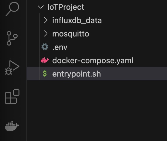

Once these components are all assembled, the project directory will appear as below.
New project file structure with influxDB
Figure 3. Modified project directory for influxDB. Image provided by the author

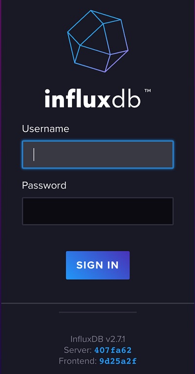

Navigate to localhost:8086, which is the local machine's port bound to the influxDB container. Using this loopback address, we can access the influxDB front end user interface. Enter the username and password set in the .env file and navigate around the UI to explore the influxDB options.
Logging into influxDB
Figure 4. Login page for the influxDB container. Image provided by the author

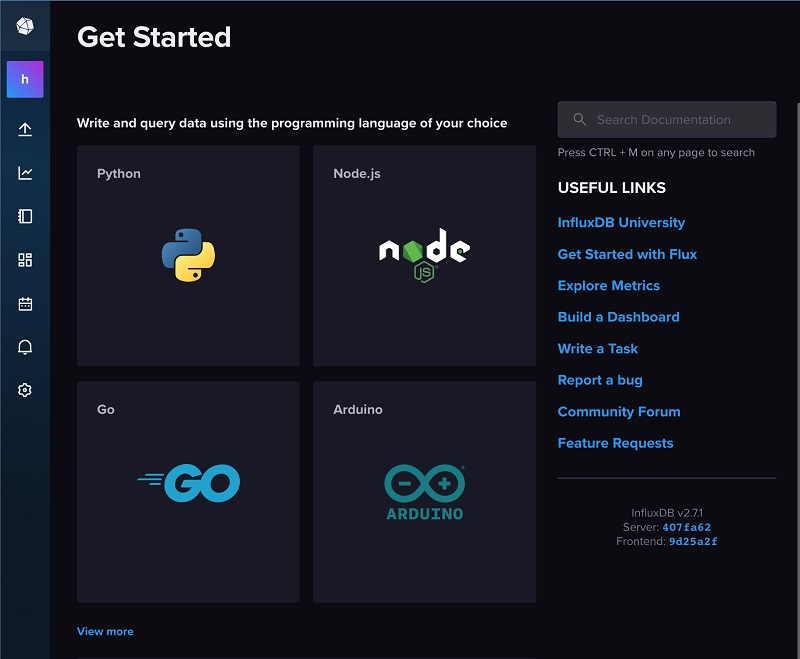

Upon entering the credentials, the landing page will appear below.
influxDB landing page
Figure 5. Home page of the InfluxDB User Interface. Image provided by the author

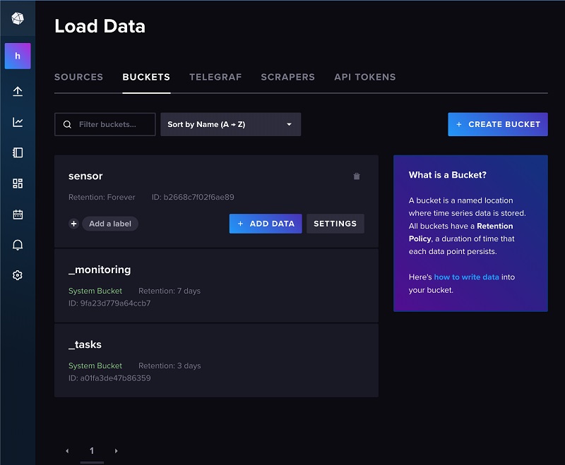

Pressing the up-arrow icon on the left will yield the sensor bucket into which we will be adding data.
InfluxDB sensor bucket for data storage
Figure 6. Sensor bucket displayed within the InfluxDB UI. Image provided by the author
