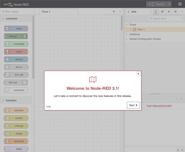

Navigating to localhost:1880 in a browser will yield the Node-RED programming environment.
Welcome screen for Node-RED
Figure 2. Intro screen to the Node-RED browser-based UI running in a Docker Container. Image used courtesy of the author

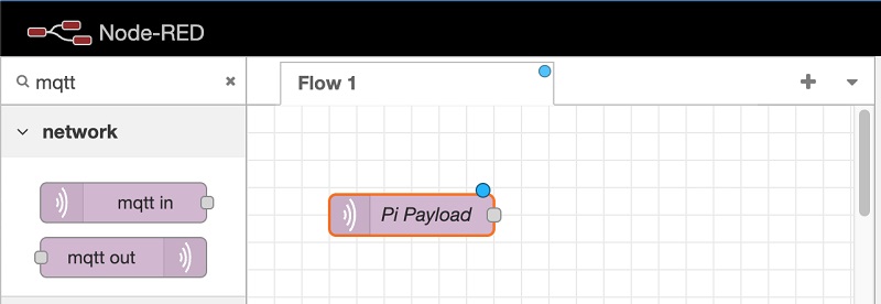

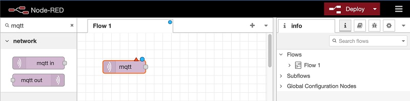

To begin the flow, an 'mqtt in' node will be added to represent the Raspberry Pi and Sense HAT payload.
New mqtt in command
Figure 3. Adding a new mqtt input channel node. Image used courtesy of the author

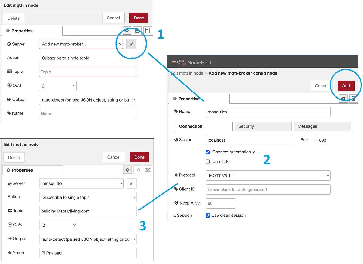

Double-clicking on the highlighted mqtt box will yield a user interface with configuration options.
In this first dialog, (1) we will add the Mosquitto broker to the Server property by clicking on the pencil next to the 'Add new mqtt-broker…'
(2) Within this new interface, add the relevant connection information and select 'Add' in red upon completion.
(3) Back in the original editing dialog of ‘Edit mqtt in node,’ enter the Topic and Name for our Mosquitto broker to which the Raspberry Pi is publishing.
Adding a new mqtt broker in three steps
Figure 4. Adding the Mosquitto MQTT broker. Image used courtesy of the author
Select ‘Done’ in red to complete the node, and a blue circle indicates a completed setup.
Connecting to the mqtt device
Figure 5. New mqtt input properly labeled with ‘Name’ field: ‘Pi Payload’. Image used courtesy of the author

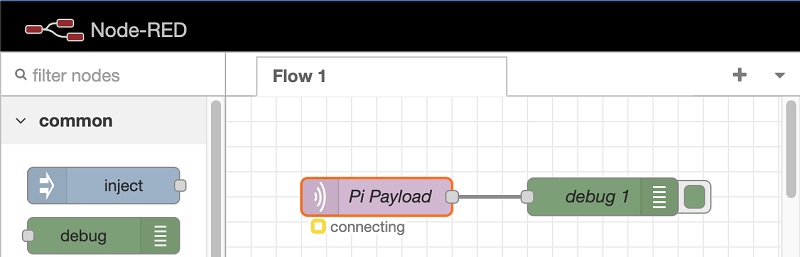

For some quick feedback on whether this was successful, we can add a debug node. Clicking the red deploy in the top right of the black bar should yield a ‘connecting’ message below the Pi Payload node. It should also display the JSON payload in the debug tab in the right pane:
Attempting to connect to the mqtt device
Figure 6. Attempting (unsuccessfully) to connect to the Pi Payload. Image used courtesy of the author
That’s strange; why does the device seem to be frozen on connecting?

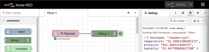

As it turns out, even though Node-RED had suggested using 'localhost' as a server name for the broker running locally, we must use our machine’s local network IP address on the network. This is different from the loopback localhost IP address. Double-clicking on the Pi Payload node and editing the Mosquitto server will re-populate the configuration window. Enter your machine's local IP address and select 'Update' in red.
Using the proper IP address in the project
Figure 7. Instead of using ‘localhost’, use the broker machine’s IP address instead. Image used courtesy of the author
Upon re-deploying, the flow should now function as we hoped, and the payload data is now displayed on the right side pane.
This is exciting that we have our first successful integration to the Mosquitto broker via subscription to the Pi Payload!
Successful connection to mqtt payload
Figure 8. Successful connection to the Pi Payload. Image used courtesy of the author
