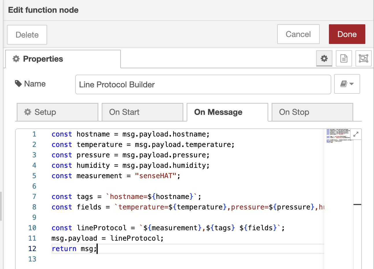

The payload can be converted by using a function node. The function node allows engineers to build custom Javascript functions to perform operations within flows. The function we will utilize simply extracts the data from the Raspberry Pi payload and formats it to the rules of Line Protocol. Insert the function node into the flow workspace.
Function node icon
Figure 2. Function node from the Node-RED workspace. Image used courtesy of the author
Double-click on the function node, enter the “On message” tab, and enter the JavaScript code below:
const hostname = msg.payload.hostname;
const temperature = msg.payload.temperature;
const pressure = msg.payload.pressure;
const humidity = msg.payload.humidity;
const measurement = "senseHAT";
const tags = `hostname=${hostname}`;
const fields = `temperature=${temperature},pressure=${pressure},humidity=${humidity}`;
const lineProtocol = `${measurement},${tags} ${fields}`;
msg.payload = lineProtocol;
return msg;
You may name the function node anything you wish; I’ve chosen “Line Protocol Builder”. Click done when finished.
Code contained inside the function node
Figure 3. Edited function node from the Node-RED workspace. Image used courtesy of the author

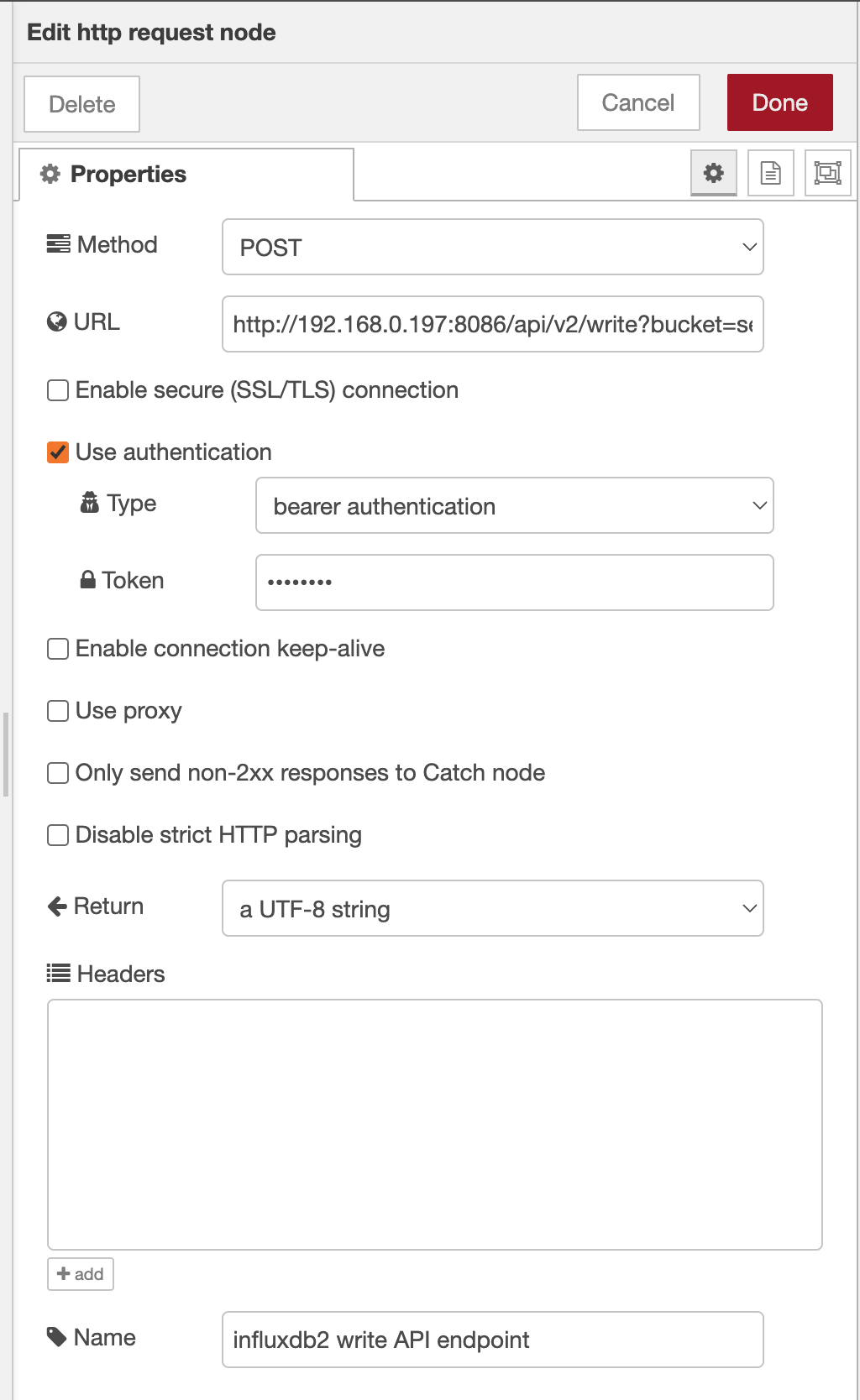

Calling the API Endpoint
Now that our payload has been transformed into the proper line protocol, we can define the request command that we will send to the InfluxDB API. To start, let's add the native http request node to our flow workspace.
http request node icon
Figure 7. HTTP request node from the Node-RED workspace. Image used courtesy of the author
Double-click on the http request, and a configuration UI will appear. For reference, we will use the API endpoint defined by the Influxdb2 documentation here. The required endpoint URL, headers, and payload are all defined within the documentation. Populate the following fields below to adhere to the documentation:
Contents of http request node
Figure 8. Edited HTTP request node from the Node-RED workspace. Image used courtesy of the author
Note the URL and Token fields are defined as below (if needed, refer back to the .env setup in Part 5 of this series):
  • URL - http://ipaddress_of_your_machine:8086/api/v2/write?bucket=sensor&org=home
    • The red fields are parameterized depending on the variable names you assigned the bucket and org values in the .env file passed to the InfluxDB container
  • Token - The token variable defined in the .env file passed to the InfluxDB container

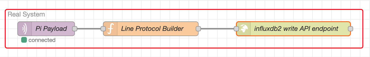

Click Done and the flow should appear as below:
Full data transfer work flow
Figure 9. Final Node-RED workflow from data input to database output. Image used courtesy of the author
