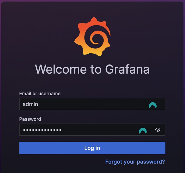

The Grafana container can be accessed at http://localhost:3000. Upon navigating to the URL, enter the username and password defined in the compose yaml file Grafana service:
Logging in to Grafana
Figure 2. Grafana Labs opening logic page. Image used courtesy of the author

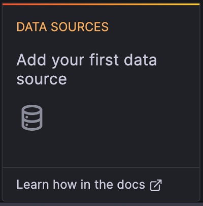

Now that we are logged in to the Grafana UI running in the container, we can begin to integrate this final step. Let’s select the ‘Data Sources’ widget and be guided through the integration steps.
Adding a data source
Figure 3. Option for choosing a first data source. Image used courtesy of the author

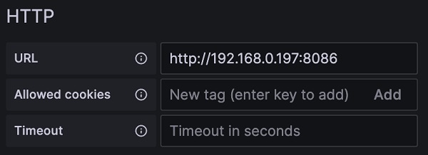

Within the HTTP section, provide the local IP address of the local machine with the port InfluxDB is bound to.
HTTP properties of IP address and port number
Figure 6. Configuring the URL field with IP address and port number. Image used courtesy of the author

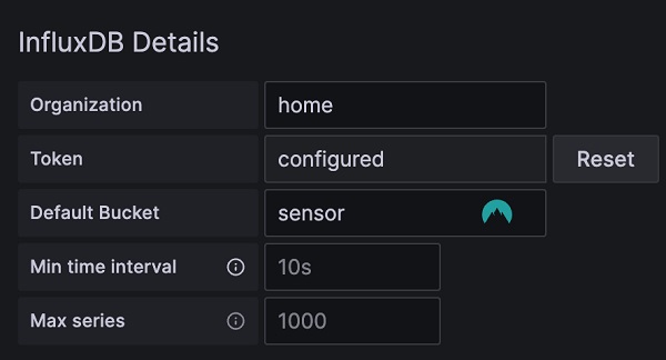

Within the InfluxDB ‘Details’ section, we will provide the organization, bucket, and token defined in the environment variable .env file for the InfluxDB service (again, review Part 5 to ensure you can find the variable details).
InfluxDB variable properties
Figure 8. Configuring the InfluxDB variable details. Image used courtesy of the author

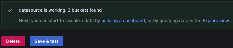

At the very bottom of the window select 'Save & test.' If the connection succeeds, a green box should appear.
Testing the final saved configuration
Figure 9. Successful test of the connection to the InfluxDB ‘sensor’ bucket. Image used courtesy of the author
Success! Within the green box, we can select ‘building a dashboard’ to begin the front-end UI work.

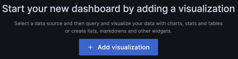

Having never used this particular Grafana service prior to this article, I was pleasantly surprised by how seamless and easy it was to get a dashboard up and running. To begin a dashboard we’ll select the ‘Add visualization’ button.
New data dashboard window
Figure 10. Adding an initial visualization for the data. Image used courtesy of the author

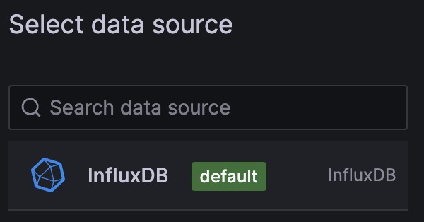

Select the InfluxDB data source we defined in the prior section.
Data source selection
Figure 11. Selecting the InfluxDB source. Image used courtesy of the author

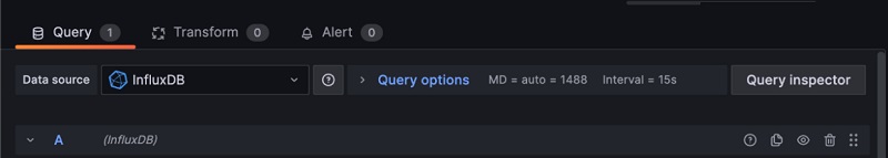

A large UI window will appear. There are an overwhelming amount of options, but let’s focus on the lower right hand pane of the window.
Query script entry
Figure 12. Specific details for Flux query script input section. Image used courtesy of the author
We can provide a Flux query within Grafana that will execute against the InfluxDB bucket. The Flux language is somewhat peculiar, and the learning curve is not something a casual user (like myself) would pick up quickly. But don't worry, this won't be a big problem!

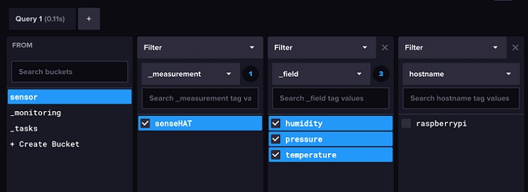

Within our InfluxDB container running on port 8086, we can have a query built for us in the Data Explorer window for the sensor bucket. In fact, we’ve already navigated to this window back in the prior article (pay attention to Figure 10 in the Part 7 article). Select 'Script Editor.'
Script editor selector in InfluxDB
Figure 13. Script editor in InfluxDB. Image used courtesy of the author
When we toggle into ‘Script Editor,’ the graphical selections we made back in Part 7...
Desired data sets from sensor 'bucket'
Figure 14. Selecting the data sets before toggling to ‘Script Editor’ mode. Image used courtesy of the author

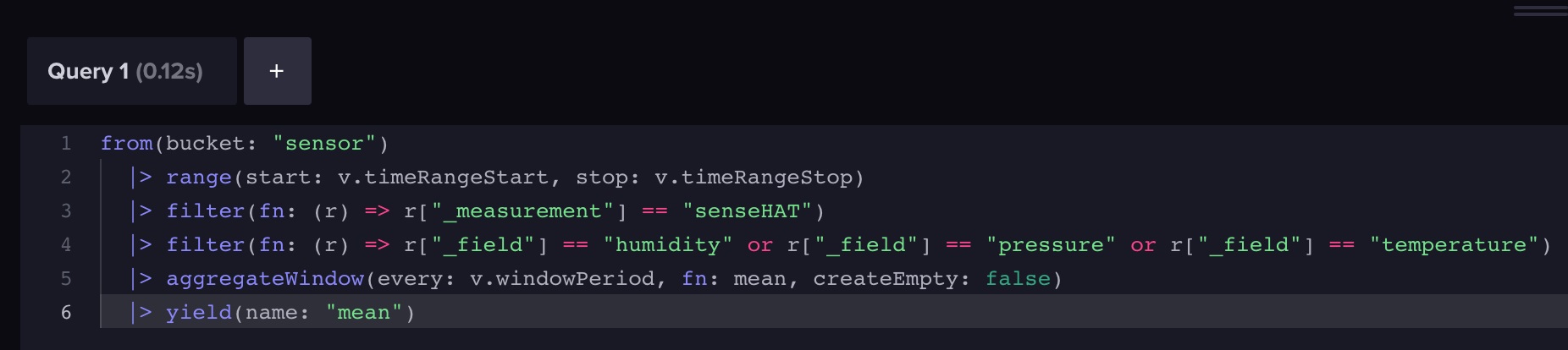

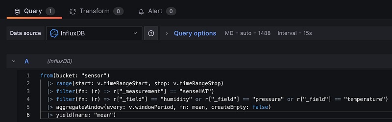

…Will be replaced with our desired Flux query here.
Script code
Figure 15. Code to be used for data query from InfluxDB. Image used courtesy of the author (click the image to enlarge)
Copy and paste this query code into the Grafana interface.
Adding script to Grafana interface
Figure 16. InfluxDB query in the Grafana workspace. Image used courtesy of the author

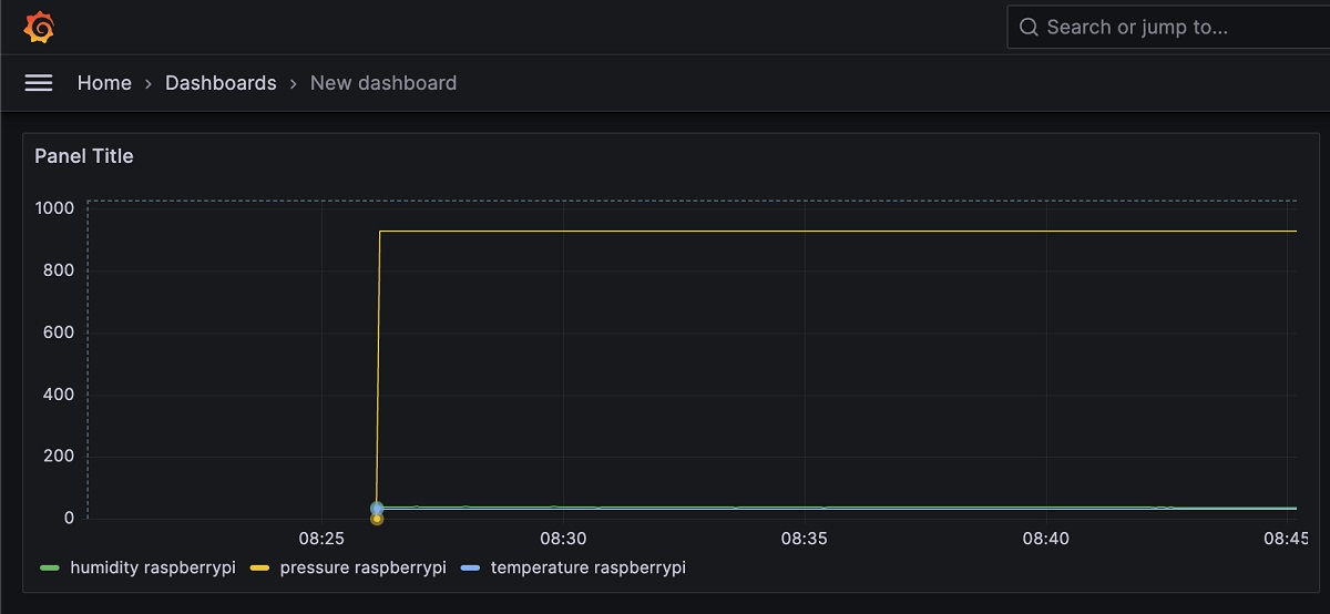

Click ‘Apply’ in the upper right hand corner. Upon doing so, we’ve created our first dashboard!
Line graphs of actual data
Figure 17. Data is displayed in a line chart time-series format. Image used courtesy of the author
Obviously, this is a skeleton example in one graph, so the formatting could greatly be improved. Hopefully, this provides a starting point for you to branch off and customize your own dashboard, with initial improvements like separating the graphs for individual y-axis scales and limits to display safe tolerance ranges.
