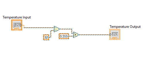

Suppose a piece of code used in the United States is now going to be shipped to an international customer, and the newest update will need to have unit conversions from Fahrenheit to Celsius throughout the program. Rather than writing the same code in multiple places, the smart action is to create a Sub-VI.
In LabVIEW, the programmer can simply write the code once. Then, drag and select the code, plus any wires leading into or out of this section of the code. Under the “Edit” menu, select “Create Sub-VI.”
Figure 1. Notice how a wire from “Temperature Input” and “Temperature Output” has been captured. The wires that lead in and out of the selection will be inputs and outputs to the Sub-VI.

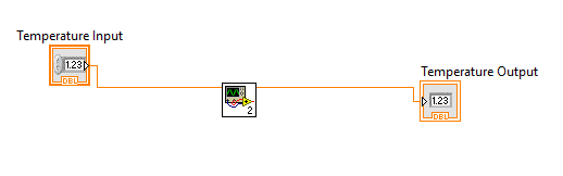

The code has now become a single block, a Sub-VI, that can be reused repeatedly. Because the Sub-VI is its own code block, it must be saved separately. Name it something that makes sense, like “F to C.vi.”
Figure 2. The simplest of Sub-VIs. This works, but the default Sub-VI icon may not be useful.

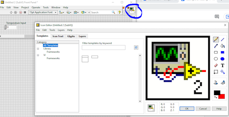

The default icon leaves much to be desired. It tells the programmer nothing about what is happening in this Sub-VI. Thankfully, there are a few ways to make this code more readable. First, double-click on the icon to open the Sub-VI. Then click on the icon in the upper-right corner. This will open up the icon editor and allow the programmer to change the icon.
Figure 3. Click in the blue circle to load the Icon Editor.

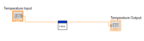

The Icon Editor lets the programmer create graphics or text to represent the Sub-VI. Take advantage of these tools; some programmers color code their Sub-VIs into categories, such as “unit conversions,” “file manipulation,” “instrument control,” and so on.
Figure 4. The icon has been modified to read “F to C.” The blue banner at the top matches the author’s convention of blue for “unit conversions and math.”

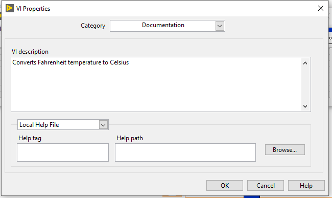

The programmer can also right-click on the icon and select “Sub-VI properties.” In this list, there is a “Documentation” option. This allows the programmer to author what text appears in the “Help” window or link the documentation to an existing file.
Figure 5. Much of the Sub-VI’s function can be controlled from the VI Properties window.
The VI Properties window can be used to alter the Sub-VI’s window at run-time (the default option does not display a new window), such as whether it can be used recursively, or other properties. It also displays how much memory it uses and how much space on the hard disk it requires.

Calling a Sub-VI is also simple. It can be searched for in the Functions Palette, dragged, and dropped into place, like any other LabVIEW block. To connect the Sub-VI, run wires to the pins on the edges of the Sub-VI, just like any other LabVIEW block.
