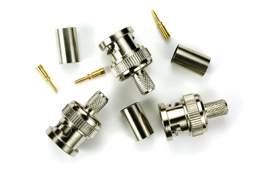

Connectors are available in several types - screw-on, screw terminal, crimp, or solder - the last two being the most common for the majority of signals. Crimp type connectors offer significant convenience.
They can often be assembled in minutes with the right tools, providing a quality connection. That time savings can be significant, leading to savings in hours and cost on a project.
Typical Crimp BNC Male.
The problem with crimped connectors is that there is a great deal of room for error. There is often great temptation to use any tool that appears to work. Sometimes even pliers get used if you find yourself in a pinch.
