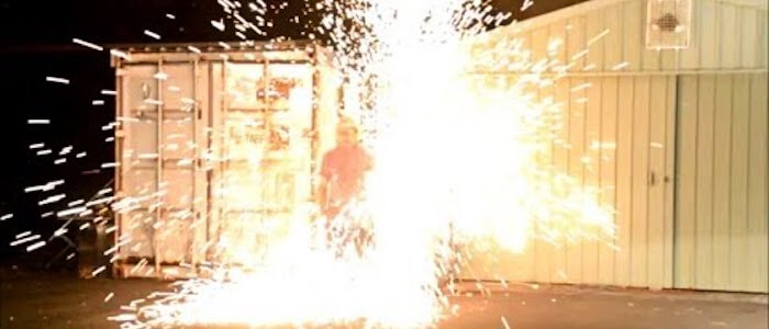

Imagine my surprise to hear a massive explosion outside the shop and half the facility suddenly go dark!
Not how I thought this day was going to go…
Figure 1. An explosion from a high-voltage capacitor bank. Image used courtesy of Peter Terren

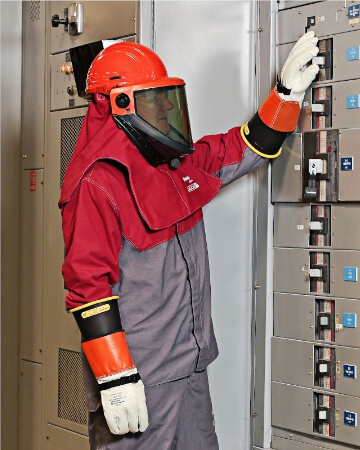

The Suit is what we call an arc flash suit. It is composed of insulated gloves, over which you wear traditional work gloves, overalls rated at 20 calories per square centimeter (cal/cm2) of power dissipation, along with a jacket and a hardhat/hood/visor combo all of the same rating. The suit is cumbersome, hot, and heavy, but it will keep you safe.
Figure 2. An arc flash suit. Image used courtesy of Honeywell
Having put on the suit, I walked into the main breaker house, which held the cabinet-sized breakers for each facility load center. In an attempt to isolate what piece of equipment blew the breaker, I shut off all the downstream breakers and began by turning the mains on with no load.
