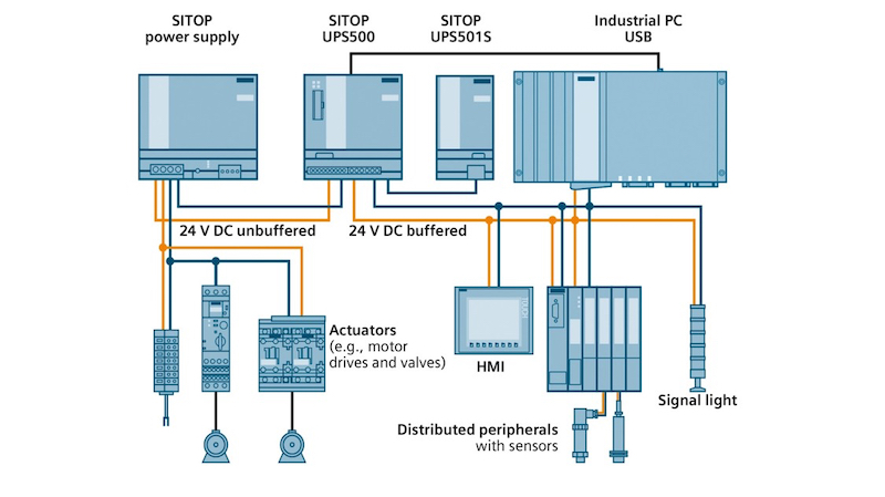

In the case of the uninterruptible power supply, the ability to remotely monitor them has opened up these devices to external networks.
Naturally, a UPS without a network card or any other way of remote accessing it is not directly exposed to a cyber-attack.
Fig. 1. A diagram showing Siemens SITOP UPS with direct connections to the control system and external networks, represented by PROFINET. Image used courtesy of Siemens

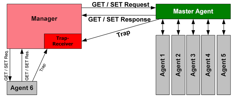

The main reason that a network-accessible UPS is vulnerable stems from the reliance on the internet standard simple network management protocol (SNMP).
Even with the improvements released with SNMPv3, this protocol can be fundamentally unsafe because the data is not encrypted. As the name states, SNMP is based on simplicity.
The protocol works using a group of eight different protocol data units (PDU) that contain variables and data about the network or the managed component (the UPS in this case). SNMP uses the UDP protocol for the data transfer, and because it is not encrypted, all the managed data is exposed.
Once a malicious attack has gained access to the data shared by one device via SNMP, the rest of a network can potentially be discovered if more devices also use SNMP or other protocols, such as Modbus or HTTP.
In addition to this, because of the broadcasting nature of SNMP, hackers can also obtain other detailed information contained within the PDU's. This information may include user credentials, firmware versions, and parametrization values.
Fig. 2. A diagram of the basic functions of the SNMP protocol. Image used courtesy of Rene Bretz

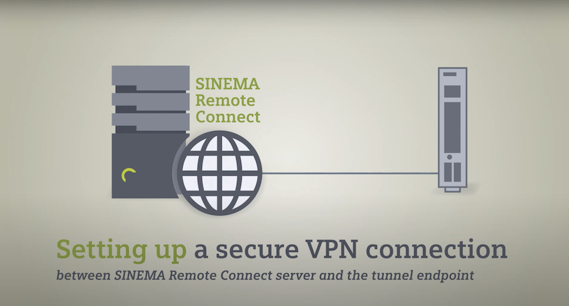

Fig. 3. SINEMA RC from Siemens is an application that helps establish a secure VPN connection to an industrial network. Image used courtesy of Siemens
Many companies are exploring better ways to control external access to industrial networks. There are now applications that establish secured remote connections using trusted certificates.
An isolated UPS network with a single point of access using one of these devices constitutes a good solution that balances security and flexibility.
