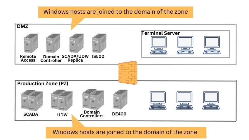

Windows Active Directory (AD)
Windows AD combines selected technologies like Kerberos, Lightweight Directory Access Control Protocol (LDAP), Domain Name System (DNS), and proprietary mechanisms to centralize common administrative and maintenance tasks. The advantage of using AD is that almost all user accounts in a zone are managed and authenticated through AD, which makes user management activities like password management easier.
Generally, at least two domain controllers are recommended in any SCADA/DCS system network to achieve redundancy. Domain controllers are servers that host an active directory domain and provide authentication and directory services to clients.
production zone and DMZ Windows hosts join the domain
Figure 2. Production Zone and DMZ Windows hosts join the domain. Image used courtesy of Author
The idea behind introducing AD in modern industrial control systems like SCADA and DCS is not to centralize account management for the heterogeneous networks, including Windows and Linux hosts, but to provide a mechanism to enforce Group Policy Object (GPO) to Windows hosts in the AD domain. So overall, we can say that accounts and policies are easily manageable by introducing the AD in the SCADA network.
