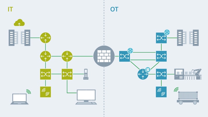

Operational Technology vs. Informational Technology (OT vs. IT)
As the names indicate, OT deals with the operational side of a manufacturing facility, and IT deals with the information side. The hardware and software used to control and monitor processes in a facility are operational technology.
Figure 1. A diagram showing the differences between IT and OT concepts. Image used courtesy of Siemens
In industrial control systems (ICS), SCADA, PLCs, sensors, and other devices that have specific functions to monitor or control other equipment in operation are part of OT. They perform certain actions in a pre-programmed manner to achieve the desired outcome in plant operations.
On the other hand, IT deals with data and information flow. It deals with the hardware and software that provides supporting technology for industrial operations. This could range from email services to manufacturing execution systems (MES). Such IT systems are not always critical to plant operations but can enhance plant operations by improving efficiency.

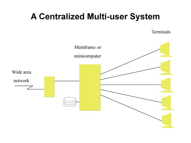

Network systems across the world operate in a centralized fashion. A single server acts as the node to store, process, and route information across the whole network. There will only be one server at the center to which all the devices are connected. Other users and devices will be able to access the information from the central server with authorized access. But this mode of centralized computing has been replaced by decentralized computing systems.
Figure 2. An example of centralized computing. Image used courtesy of Loyola University Chicago

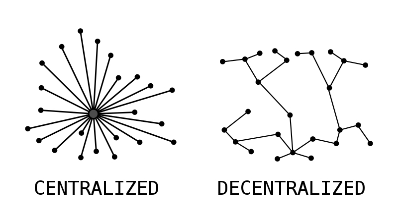

There is no single server at the center in decentralized computing systems, but there are interconnected clusters with a node at their centers. These nodes are connected. Computing power is not limited to a central server but is spread across many nodes. This is a much more efficient operation model, as the possibility of a fault taking down the whole system is very low.

In a centralized computing model, the central server is the key vulnerability. If the central server is compromised, the whole system goes offline, and the operations can be halted. A single point of attack can bring down the complete system. Importance has to be given to protect the central server.
In a decentralized and distributed model, the attack vector is much wider. Even if one of the nodes or devices is compromised, the rest of the system can remain operational.
Figure 3. An example of centralized vs. decentralized in the context of computing. Image used courtesy of Adam Aladdin [CC BY-SA 3.0]
Also, if identified, the affected part of the system can be severed off while the rest of the system remains operational. But if the security breach goes unidentified, malware can spread across the network and infect all nodes and devices.

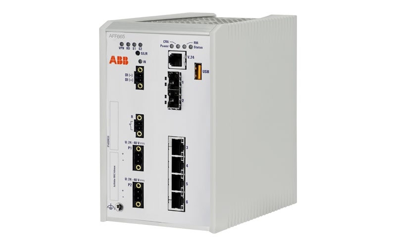

The firewall provides network security by constantly monitoring the data that flows through the network. It is a system that uses both hardware and software technology to prevent cyberattacks. They block and divert traffic based on a predefined set of rules for the network. A firewall implemented by vendors with a proven track record has to be the first line of defense for every ICS implementation.
Figure 4. A multi-port industrial firewall with enhanced security features that comply with utility and industrial standards. Image used courtesy of ABB
