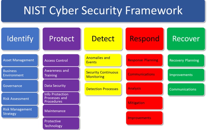

Cybersecurity recommendations from NIST follow the NIST Cybersecurity Framework – probably the single most referenced source of information for best practices in cybersecurity. The framework applies to computer systems of all sorts, including control systems, and is a comprehensive way to think about cybersecurity.
NIST Cybersecurity Framework. Image courtesy of CyberSecurity.org.
The framework is organized around five functional areas followed by 22 categories, which are shown above, and 108 subcategories (which are not). The complete framework includes "Informative Resource" references for each subcategory connecting these requirements to specific sections in a variety of other information security standards – sort of a cross-reference for all of them.
