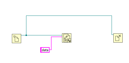

Suppose a programmer needs to write a simple VI to open a file, write some data, and then close it.
incorrect open file
Figure 1. Incorrect: The open file node will run first.
After the open file node runs, both write to file node, and the close file nodes are eligible to run (indeterminate), as both have all required inputs met. If the close file executes first, the write to file node may write to unallocated memory.

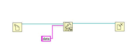

To correct this, the programmer should ensure that the wires run from the open file node to the write to file node to the close file node. This wiring pattern will ensure that the open file node executes first, followed by the write to file node, then the close file node. This way, the write to file node is guaranteed to write to an actual file instead of an unallocated piece of memory, which can cause the infamous “blue screen of death” on Windows machines.
correct open file
Figure 2. Correct: The open file node will run first.
The close file node cannot run until its input is met. Therefore, the write to file will run second; then, the close file node will run. They have to run in this order, meaning the system is determinate.

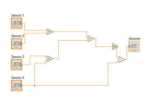

In this hypothetical math routine, some of the sensor values are multiplied together, added, incremented, and subtracted for the equation:
(((X1 * X2) + (X3 * X4)) + 1) - X4 = Answer
From math class, the inner sets of parentheses must be performed first, then the next set of parenthesis, and so on. Some order is required, but the program can perform either X1*X2 or X3*X4 first. Those two terms do not need to be determinate.
indeterminate elements
Figure 3. Some indeterminate elements: There is no way to determine which multiply node will execute first.
After the nodes have executed, the rest of the nodes are determinate, and have a set run order:  add, increment, subtract. As it turns out, it does not matter which multiply executes first.

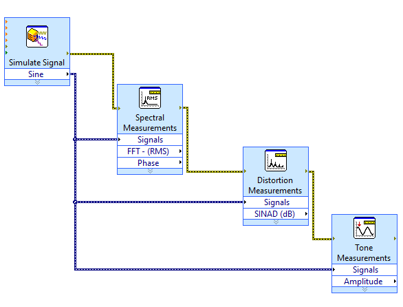

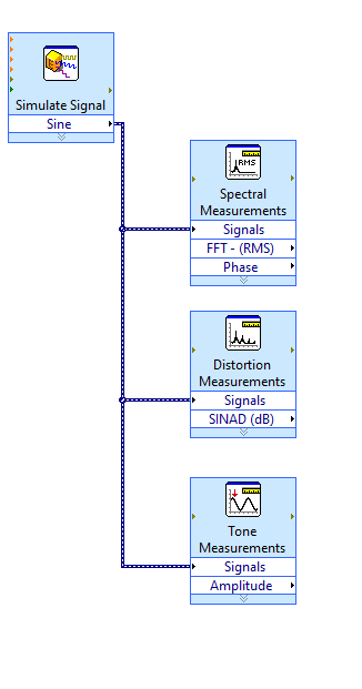

Figure 4. Simulate signal must happen first; after that, spectral, distortion, and tone measurements are indeterminate.
error clusters
Figure 5. Using error clusters can determine the order, plus any problems can be handled.
