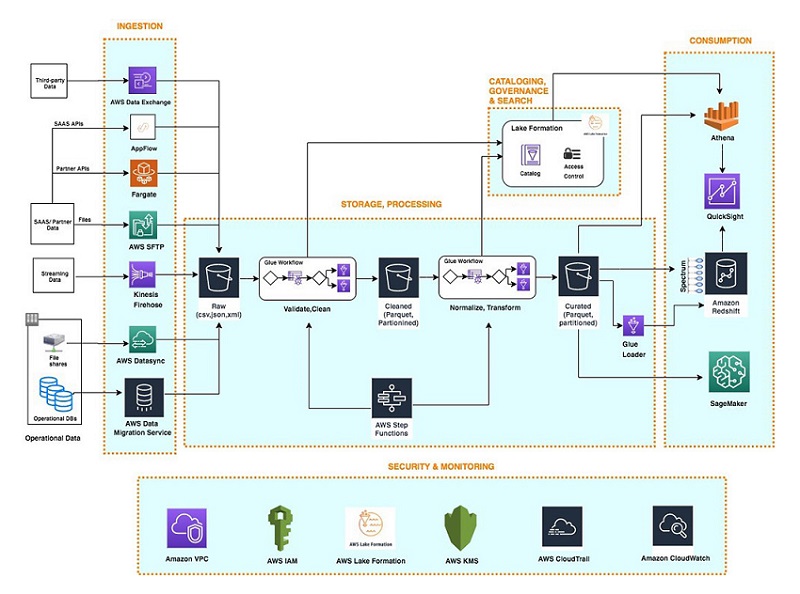

The subject I am referring to is the flow of data within large corporations. There is quite a bit of unseen, invisible work that happens behind the front end of every MES/SCADA application or manufacturing operations report. This field of work is often performed by data engineers, architects, and analysts, quite out of mind for equipment engineers. To give a more visual example of the complexity, refer to the example system architecture provided by Amazon Web Services in Figure 1 below.

Data management workflow diagram
Figure 1. AWS data flow example. Image used courtesy of AWS

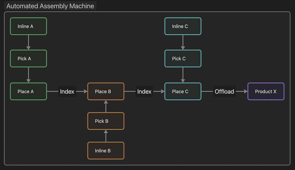

Let’s say you are a controls engineer responsible for the OEE of a 24/7 automated assembly machine. This machine produces product X, composed of 3 child components A, B, and C. Unfortunately, the company's SCADA system is in its infancy. The only data you have available are a few text or CSV files spit out by the local HMI on the machine after each production run.
The OEE of this particular machine has been disappointing, and leadership has entrusted you to make it better. This has been a major thorn in your side, though. Combining and aggregating the required raw data and transforming it into a usable summary has been exceedingly difficult.
How can you control the data of your machine to drive increased business productivity?
Simplified machine data flow diagram
Figure 2. Block diagram overview of the example challenge system. Image used courtesy of the author

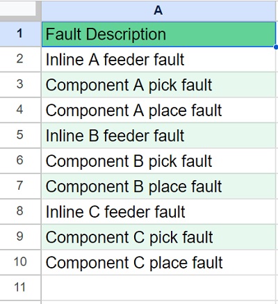

Within a single sheet column (A1:A10) we can define a fault dimension table filled with possible unique fault types for the system illustrated above in Figure 2.
Table for fault types
Table 1. Possible fault list

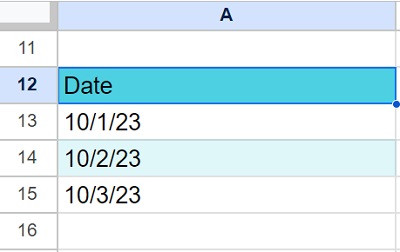

Just below this first table, we will now define another dimension table for dates in cells A12:A15. This will list the possible dates on which faults were recorded for a single 72-hour manufacturing run.
Table for fault dates
Table 2. Possible date list

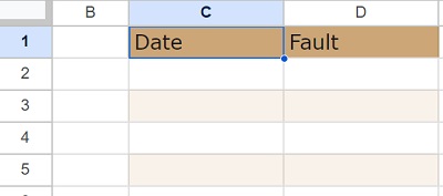

Finally, we will build a randomly generated ‘fault’ dataset pulled from this hypothetical 72-hour manufacturing run. In cells C1 and D1, we will name headers ‘Date’ and ‘Fault’ respectively.
Table to fill with generated random faults
Table 3. Generated fault list headers

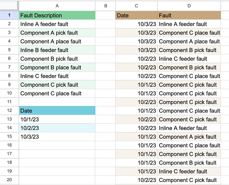

In cell C2, we will choose a random date, plucked from the date dimension table (Table 2) using the cell formula.
=INDEX($A$13:$A$15,RANDBETWEEN(1,3))
In cell D2, a random fault can be paired with the random date from the fault description dimension table (Table 1) using the cell formula.
=INDEX($A$2:$A$10,RANDBETWEEN(1,9))
The fill handle can be used to carry this formula downwards for any number of records. I chose a sample size of 499 randomly generated records for the purposes of this article. Altogether, the sheet should look similar to below (note: many more rows of data continue below the bottom of the image).
Generated fault record datasheet
Figure 3. A simulated fault records file in columns C and D. Image used courtesy of the author

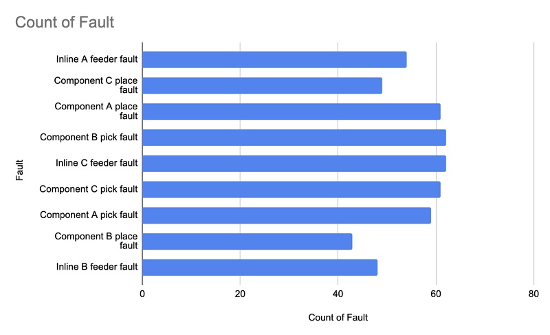

The simplest solution in this scenario would be to build charts and analytics within Excel or Google Sheets. Excel is one of the most widely used data analytics tools out there. Building out a Pareto chart or even a pivot table of faults would not be that difficult with this given data array. One convenient example based on our randomized generation approach could look like the graph below.
Fault analysis chart
Figure 4. Example of adding analytics within the spreadsheet. Image used courtesy of the author
However, this solution quickly starts to fall apart when applied to a larger industrial scale seen with any real-world application. How often will you need to manually append new data from future manufacturing runs? How will you maintain data quality in a “master” Excel document? Over time will the Excel file performance begin to degrade as records saturate the sheet?
As you can see, analytics within Excel works great for ad-hoc analysis, but at scale, it has some serious flaws.
