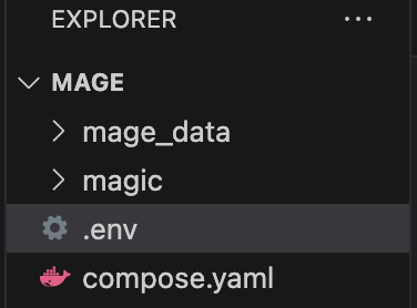

Within a project directory, the files will appear as such.
Beginning project file directory
Figure 3. File directory before docker compose. Image used courtesy of the author

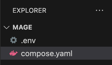

When the specified volume is mounted, several new directories will be created within the host machine’s project folder. This allows files to be shared from the local machine to the container.
Complete project file directory
Figure 4. The complete project file directory. Image used courtesy of the author

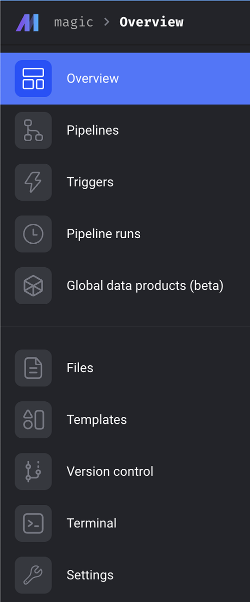

Navigating to localhost on port 6789 will yield the mage.ai container UI. The options within mage.ai include the below features.
Mage.ai menu options
Figure 5. Mage.ai menu options. Image used courtesy of the author

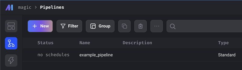

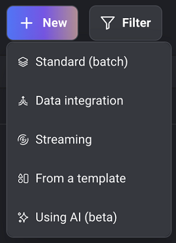

Since we intend to focus on data pipelines, let’s select the pipelines tab and explore this menu first. The container will already have a default standard ‘example_pipeline’ set. Select the ‘New’ button to see the different types of pipelines offered.
New pipeline creation button
Figure 6. Creating a new data pipeline in mage.ai. Image used courtesy of the author
You’ll notice that there are three main types of common pipeline foundations offered to build on top of:
  • Standard (batch): Data is accumulated in a ‘batch’ at the source and sent or uploaded on a manual or scheduled time interval. It moves a bunch of data at once to the destination.
  • Data Integration: The synchronization of the data source system with another system.
  • Streaming: The integration or subscription to a publish/subscribe-based system such as an Azure Event Hub or Apache Kafka stream.
Pipeline input options
Figure 7. Options available for creating a new data pipeline in mage.ai. Image used courtesy of the author
Select the ‘Data integration’ option displayed above, and we can now take a short pause on the pipeline that appears.
