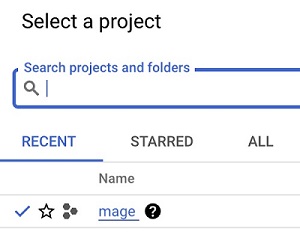

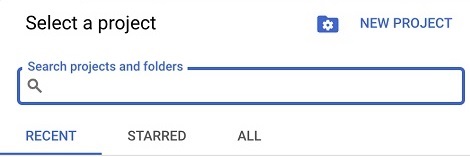

  2. Click on ‘Select a project,’ where you will need to create a new project in the top right corner:
    Selecting a project in Google Services
  3. Create a new project name and it will appear similar to below (I have named this new project simply ‘mage’):
    Creating a new project in Google Services

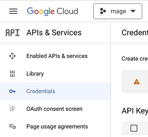

  4. Navigate to the credentials subsection of the ‘APIs and Services’ pane:
    Credentials application menu in Google Services

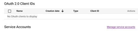

  5. Click 'Manage Service Accounts':
    Managing service accounts in Google Services

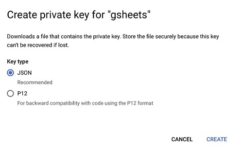

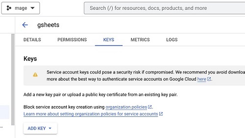

  7. Generate a key for the service account by clicking the ‘keys’ tab and the ‘Add Key’ button, being sure to select the JSON type:
    Creating config file in Google Services
    Choosing JSON as the file type

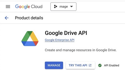

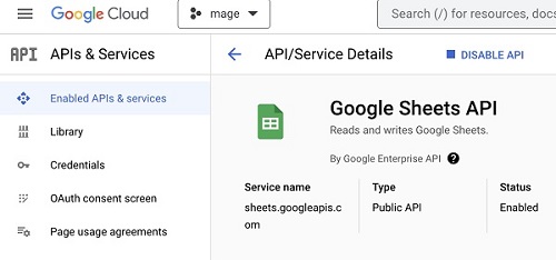

Remember that service accounts are not related to your own personal Google Drive workspace. Therefore, there is one additional authorization that we must enable within our own user account, including activating the Google Sheets API and then sharing the document.
  1. Within the project, search for “Google Drive” to enable the Google Drive API:
    Google API authorization
  2. Within the project, search for “Google Sheet” to enable the Google Sheets API:
    Enabling Google Sheets API

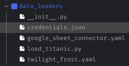

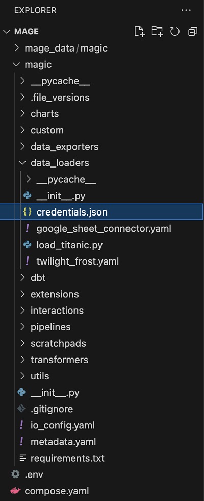

First and foremost, do not share this file with anyone or save it in a public space. When you generated the JSON credentials file, it should have saved in the ‘downloads’ folder of the host machine. Locate it and move it into the project directory that is shared with the docker container via a host-mounted volume.
I’ve chosen the data_loaders directory since the credentials are used within the context of that space, but you may choose anywhere in the mage_data/magic directory you wish. I’ve renamed the file to obscure the leading characters of the private_key_id, as well as for general better readability.
File directory in mage project
Figure 3. Complete structure for local mage directory. Image used courtesy of the author
The configuration file will now appear in the mage container.

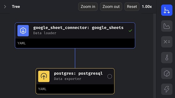

In the right-hand visual tree of the pipeline, the source block should also have a green checkbox associated:
Successful test in workflow diagram
Figure 8. Green check indicating successful connection. Image used courtesy of the author
