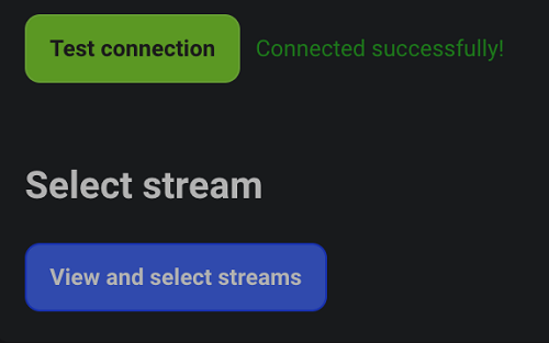

Let’s continue progressing through the development of the data pipeline in the mage editor running on localhost:6789. There should be an option to select a stream below the test connection button.
Button for selecting the data stream
Figure 2. Stream selection option. Image used courtesy of the author

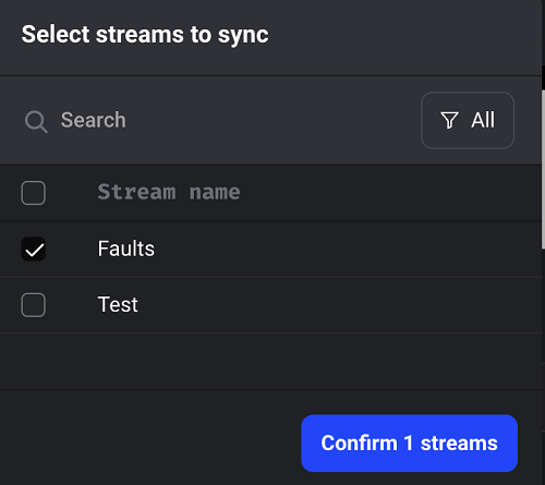

Therefore, upon selecting “View and select streams,” the following window will appear.
Choosing tabs to stream data
Figure 4. Selecting the proper data stream. Image used courtesy of the author
Please select the sheet that contains the Fault data built in part 1 of the series, and click on the blue “Confirm 1 streams”. The Test sheet, in my case, was a sandbox sheet used for debugging purposes. Keeping this sandbox sheet around would be a good demonstration of the selective integration capability of the Google Sheet integration connector.

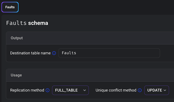

Creating a new data storage table
Figure 5. Creating a storage table from the data stream. Image used courtesy of the author
The “Destination table name” is what we are going to call the table that will be created within the Postgres database upon loading data. The usage section tends to be fairly detailed. For simplicity, understand that with each run of the pipeline, we will be erasing and then uploading the most recent data.

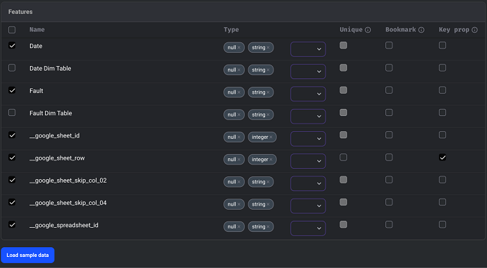

Below these options, there is a featured widget. This widget allows us to select which columns within the fault sheet we would like to store in the database. I’ve excluded the dimension tables and have only kept the randomized “fact” table entries.
Data column selection options
Figure 6. Choosing individual columns from the data stream spreadsheet. Image used courtesy of the author

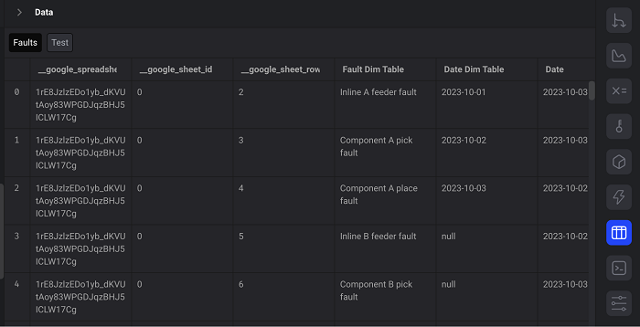

Clicking on “Load sample data” will yield a snapshot of what the data looks like in the Google Sheet in the right hand window pane.
Instant data snapshot from the spreadsheet
Figure 7. Sample data from the Google Sheet source stream. Image used courtesy of the author

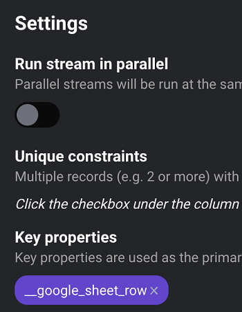

We’ll leave the settings section below unchanged.
Stream settings
Figure 8. Stream settings. Image used courtesy of the author

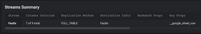

A summary of the selections will be given at the end streams section.
Summary of completed data stream setup
Figure 9. Stream selection summary. Image used courtesy of the author

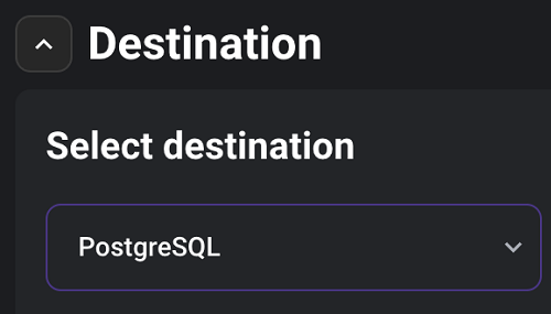

Within the destination section, choose “PostgreSQL” from the drop down list.
Choosing the destination for the data
Figure 10. Selecting a data destination. Image used courtesy of the author

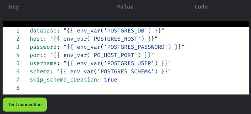

A text block will appear below this selection and will even contain a link to documentation. Again, the mage.ai team approach to data pipelines is new; documentation embedded within building a pipeline encourages best practices and guides IT and OT professionals through the construction process. Truly a great feature of the platform. We will need to enter the connection data for the Postgres database container below. The secrets were passed to the mage.ai container in the form of environment variables in the .env file upon startup.
Connection data required for Postgres connection
Figure 11. Postgres connection data passed from the .env file. Image used courtesy of the author
Clicking on the “Test connection” button should yield a successful connection.

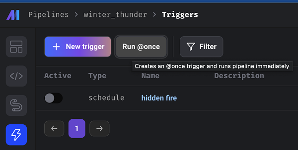

With the pipeline defined, we will need to run the pipeline in order to transfer data. Generally, runs are achieved through Triggers. Triggers are an event that prompts the pipeline to run and can include a scheduled daily time, API call, or event from a publish/subscribe architecture. To keep things simple, we will select the “Run@once” button to manually trigger the pipeline.
Button for running the data collection routine
Figure 12. Run @once button to run the pipeline. Image used courtesy of the author
This will yield a randomly named trigger that will execute the data pipeline. If all goes well, the completed status will appear.
Complete status on the data pipeline
Figure 13. Completed pipeline. Image used courtesy of the author

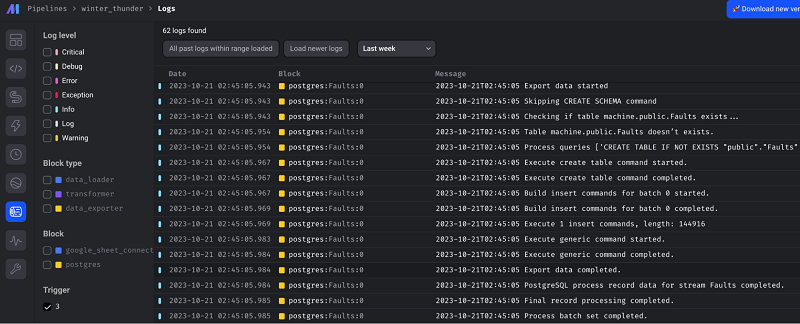

To see more of a step by step playthrough, you can select the logs cylinder icon in blue to view the progression of the pipeline run.
Log of previous data collection runs
Figure 14. Log report of previous data pipeline runs. Image used courtesy of the author

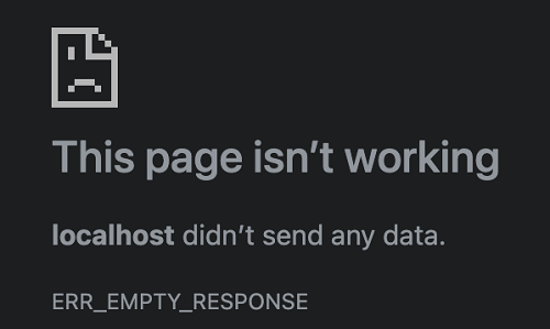

Our pipeline ran successfully! So now the question remains: how do we see the data in our Postgres database? Navigating to localhost:5432, we’re met with something strange.
Error message to be handled in Part 5 of the series
Figure 15. GUI error message… To be continued. Image used courtesy of the author
The reason the page isn’t responding is because the Postgres database container does not have a front-end visual UI. Managing the stored data could be accomplished via command line prompts, but that’s difficult to visualize.
