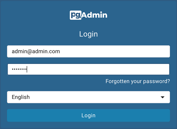

Enter the localhost:5050 loopback address into a web browser to display the pgAdmin GUI. Enter the environment credentials defined in the pgAdmin service defined in the compose.yaml file to log in.
Login screen for pgAdmin
Figure 2. pgAdmin login screen. Image used courtesy of the author

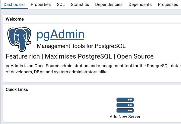

After successfully logging into pgAdmin, you will be met by a friendly dashboard. One of the first steps is to link the GUI to the backend Postgres machine database that we provisioned in the prior articles. To do so, select “Add New Server”.
pgAdmin 'add new server' button location
Figure 3. Add New Server dialog. Image used courtesy of the author

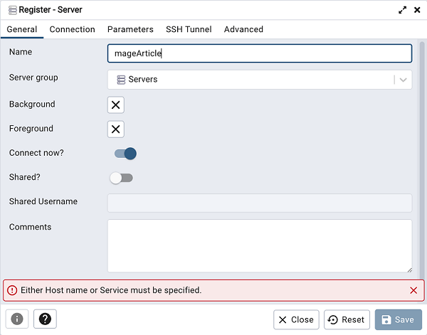

A popup menu will appear with additional fields to complete. In the general tab, a name section exists to identify the database server with a friendly name. You may name the server whatever you wish; I have chosen mageArticle.
Parameters for selecting a new pgAdmin server location
Figure 4. New server creation parameters. Image used courtesy of the author

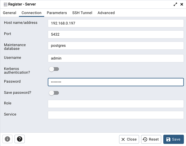

The red exclamation mark is prompting us to define the connection properties for the Postgres database server. Click on the connection tab and enter the parameters defining the containerized Postgres serving running on the local host machine. The “Host name/address” field should be the IP address of your host machine.
pgAdmin server connection properties
Figure 5. Adding server connection properties. Image used courtesy of the author
Upon clicking save, the server name should appear in the left-hand Object Explorer menu.

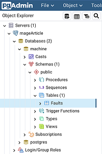

In order to see table data from the mage.ai pipeline in part 4, we will expand the Object Explorer menu in a descending manner from server -> database -> schema -> table. The Faults table (or whichever Google Sheet name you chose) should appear in the hierarchy. Please note you may need to rerun the manual “Run@once” pipeline trigger in the mage.ai pipeline and refresh the pgAdmin browser window.
File tree for spreadsheet location
Figure 6. Location of the ‘Faults’ spreadsheet (complete file tree has been truncated for image clarity; yours may be longer). Image used courtesy of the author

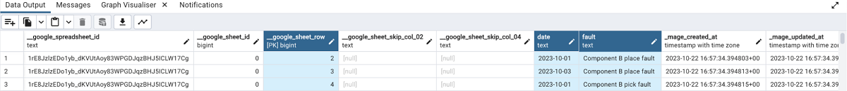

To visualize the Faults table values, select the View Data button located at the top of the object explorer window.
Upon selecting this button, a center dashboard will appear with an overwhelming amount of content. Do not be alarmed, many database systems have a similar UI. Once you learn one, any subsequent systems become easier to understand.
Information from fault data spreadsheet
Figure 7. Partitioned information from the ‘Faults’ spreadsheet. Image used courtesy of the author

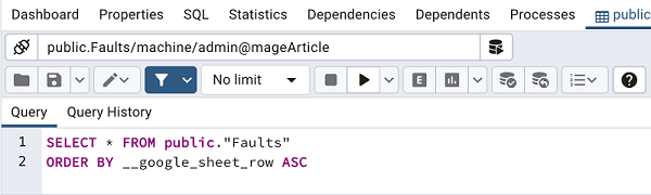

Let’s break down the UI above. The query pane was auto-generated by selecting the view data button. The query serves as a critical component in all relational database systems. It communicates with the database and returns the data requested by the query. The language of most relational database management systems is Structured Query Language, or SQL. In the auto-generated case described, the query is pulling all records from the Faults table and ordering them in ascending order based on the google spreadsheet row ID.
Selecting specific data from spreadsheet
Figure 8. Query organized by spreadsheet row number. Image used courtesy of the author

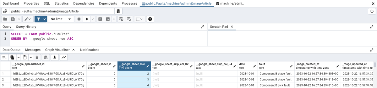

The data output tab below reflects this request. Examining the first 3 rows, we can see that the _google_sheet_row ID begins at 2 for the first row returned and incrementally increases as you scroll downwards in the result set. Furthermore, we can see the “fact” table records we loaded through the mage.ai pipeline in the form of the “date” and “fault” columns.

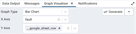

An ad-hoc data analysis approach, similar to the Google Sheet chart in part 1, can be accomplished within the pgAdmin tool. Clicking on the Graph Visualizer button will generate a visual chart of the resultant data set of the query.
Within the graph visualizer menu, select the following options, and click “Generate” in the top right-hand corner.
Setting a new visualization type (graph)
Figure 10. Generating the visual graphic element. Image used courtesy of the author

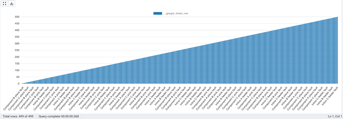

Remarkably, we will get a bar chart of the resultant query dataset. The data is not aggregated and thus not ideal for presentation purposes.
Data graph, although poorly sorted at the moment
Figure 11. Non-aggregated data display. Image used courtesy of the author

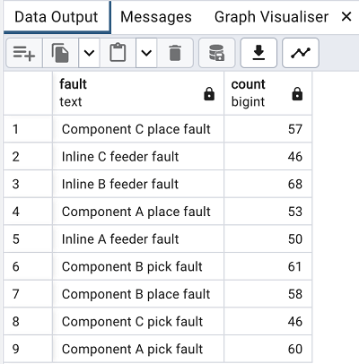

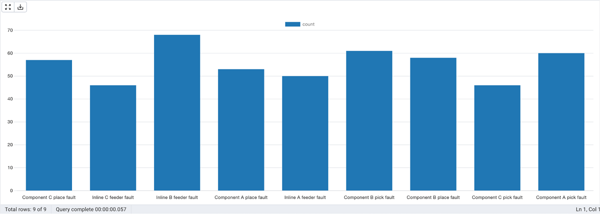

Creating a new SQL query can change the graph visualizer into a format that is more desired for presentation purposes. Enter the following SQL statement into a new query editor window. This statement performs an aggregate count function on the fault data and then groups the counts associated to the respective descriptions.
SELECT
	fault,
	COUNT(fault)
FROM
	public."Faults"
GROUP BY
	fault
The resultant dataset should be similar to below.
Listing of tabulated numerical data
Figure 12. Tabulated set of fault data and count number. Image used courtesy of the author
The resultant graph visualizer tool will yield a much more effective graph to present to management.
Completed bar graph of data - see how nice that looks?
Figure 13. Aggregated bar graph display of fault data. Image used courtesy of the author
