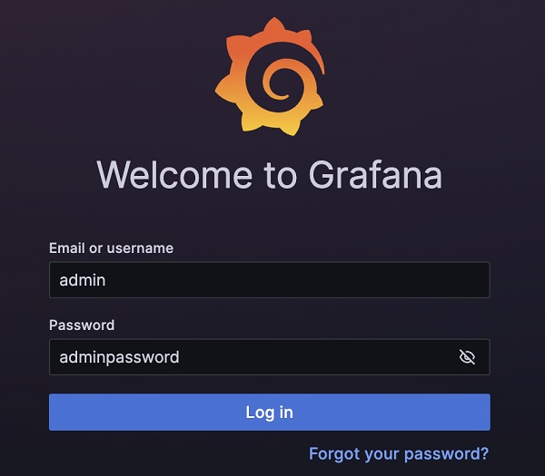

Entering the command docker compose up -d in a terminal window of the project directory will start up the containerized applications defined in the yaml file. The Grafana dashboard can be accessed at http://localhost:3000. You should be greeted with a login UI, where you may enter the GF_SECURITY_ADMIN_USER and GF_SECURITY_ADMIN_PASSWORD values defined in the compose.yaml file. Obviously, my choices of values are weak for security and are only appropriate for our introductory demonstration purposes:
Grafana login screen
Figure 2. Grafana login page. Image used courtesy of the author

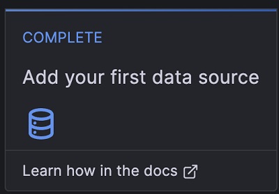

Upon logging into the platform, our first step is to connect to the Postgres database. In the welcome window, select the following icon:
Grafana data source widget
Figure 3. Integrate a data source widget. Image used courtesy of the author

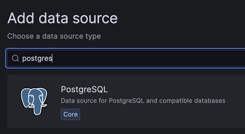

Search for Postgres in the search bar and select the PostgreSQL service that appears:
Grafana SQL integration widget
Figure 4. PostgreSQL integration widget. Image used courtesy of the author

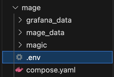

Upon selecting the widget in Figure 4, you should be directed to configure the connection to the Postgres database. The configuration will mirror the environment variables defined in the .env file of our project directory. These are the same values passed to the Postgres container in the compose.yaml file here:
Project environmental variables file
Figure 5. The environment variables can be found in the .env file. Image used courtesy of the author

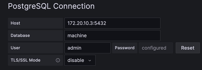

With all configuration values in hand, complete the connection information of the widget:
Connection interface information for PostgreSQL
Figure 7. Entering connection info for Grafana integration to PostgreSQL. Image used courtesy of the author
At the bottom of the UI, save and test the connection with the blue button. It should yield the transparent green “Database Connection OK” notification if all goes well.

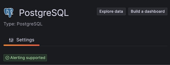

Finally! We can get to designing the visualization. This piece of the solution is by far the most tangible and visible to the leadership stakeholders in our use case. It will provide a peek and summary into the health of the machine you have been tasked to improve. In the same configuration window we left off in Figure 8, scroll back up to the top and select “Build a dashboard” in the top right-hand corner:
Setting up a first data visualization dashboard
Figure 9. Build a dashboard. Image used courtesy of the author

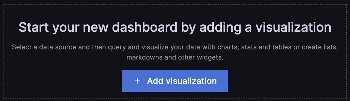

The next guided step is to create a new visualization; Grafana certainly makes the workflow intuitive and easy to follow:
Beginning the data dashboard configuration
Figure 10. Add a new visualization. Image used courtesy of the author
You’ve now entered a sandbox world where there are many options that can showcase the data. I can’t begin to cover all possible visualization scenarios, so I encourage you to explore the vast set of features. However, I will offer some basic solutions and believe that Grafana offers a great product for customized dashboards.

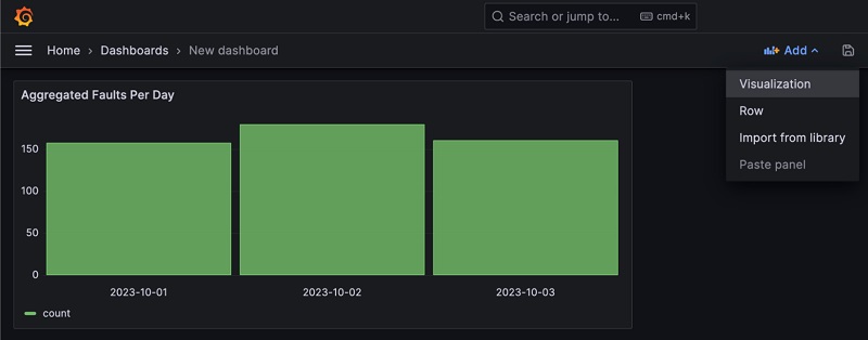

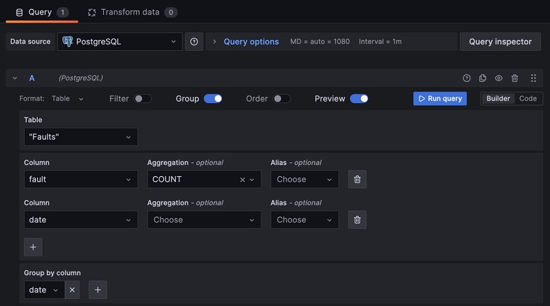

The first scenario is a high-level fault per day count. Within the query tab, enter the following configuration settings. Notice that the components are sourced from the Faults table in the PostgreSQL database:
Setting properties for the data query
Figure 11. The Query settings interface. Image used courtesy of the author

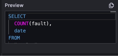

Below the Query editor window will show the corresponding SQL query associated with the settings selected. Grafana makes things somewhat easier by building the SQL code from the “clicking” UI.
SQL code for generating data
Figure 12. SQL code generated from parameter selection in Figure 11. Image used courtesy of the author
Clicking apply on the visualization will complete the first graph. You will now see a preview of the dashboard and have the option to add additional graphs with the “Add” button below:
First graph of faults per day
Figure 13. Aggregated Faults Per Day graph. Image used courtesy of the author

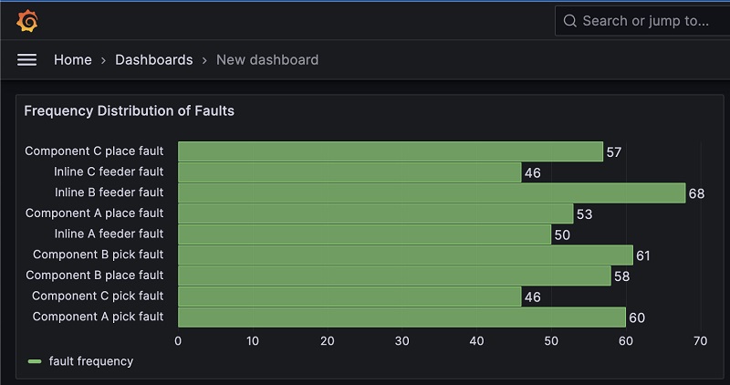

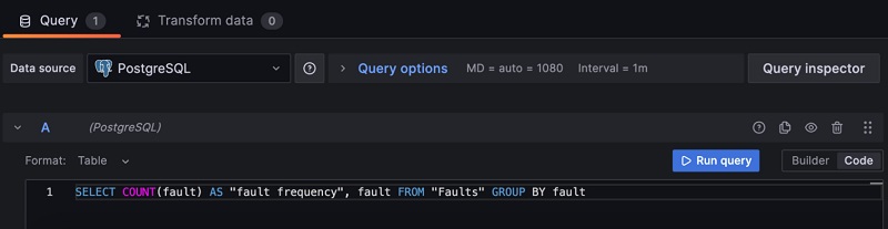

A second potential visualization could be the frequency of faults for the 72-hour run. In the query builder tab from the newly created visual, we can create a query using SQL code instead of using the UI tools here:
Query code editor
Figure 14. Code selection in the query tab. Image used courtesy of the author
We can enter the query below:
SELECT COUNT(fault) AS "fault frequency", fault
FROM "Faults"
GROUP BY fault
Into the box here:
Setting the SQL query
Figure 15. Entering the SQL query in the UI. Image used courtesy of the author
Clicking on apply will yield the following dashboard:
Graph of fault frequency distribution
Figure 16. Fault frequency distribution for the 72-hour run. Image used courtesy of the author
