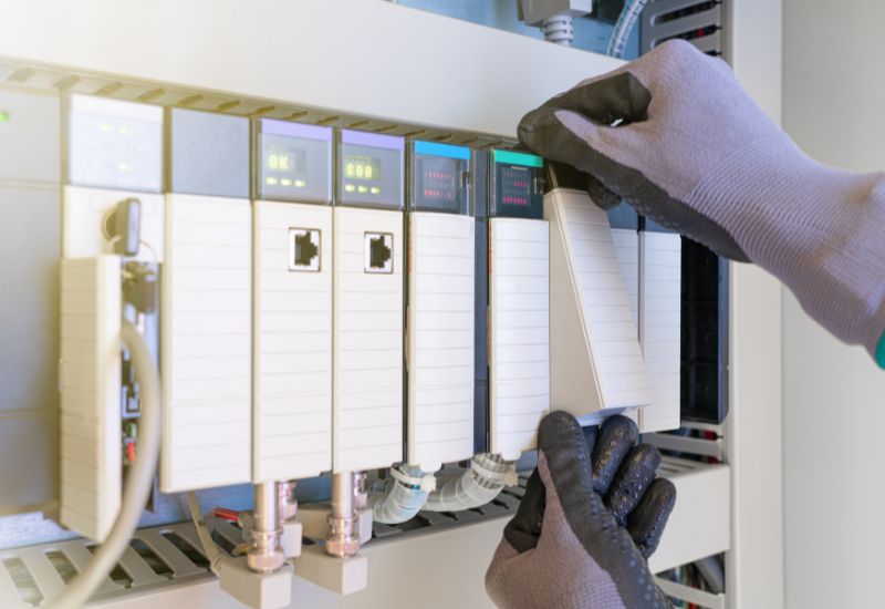

Websocket is a full-duplex communication channel
Figure 2. Websocket is a full-duplex communication channel that is faster and uses less bandwidth than uni-directional HTTP. Image used courtesy of Canva
