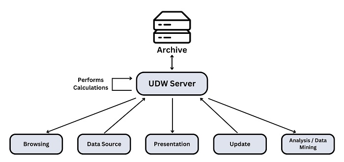

The UDW, or utility data warehouse, is a system for storing time series, historical, and future data. The UDW server's main functionality is storing data in a relational database management system (RDBMS) for use by various other client applications. The diagram below shows possible operation functions for industrial applications.
UDW function diagram
Figure 1. Presentation, browsing, and updating are functions for viewing and updating data stored in the UDW
Tabular and graphical presentation, browsing, and Excel-based reports are the functions for viewing and updating data stored in the UDW.
Modern SCADA systems can store historical data for creating reports like hourly, daily, weekly, and annual reports. All power utilities need to record information for reporting purposes to measure the performance of the power system operations. However, many industrial control systems are usually not designed and equipped with analysis tools, so if we integrate the UDW functionality (especially reporting) in the online SCADA system, it will load the system unnecessarily.
The UDW system is connected to some external systems, typically a SCADA/EMS/DMS. The data source is a function that records data into the UDW and further analysis and data mining are functions for refining and processing that data. Analysis and data mining software normally require the creation of queries against the UDW database; thus, the knowledge and understanding of the UDW data model are prerequisites.
