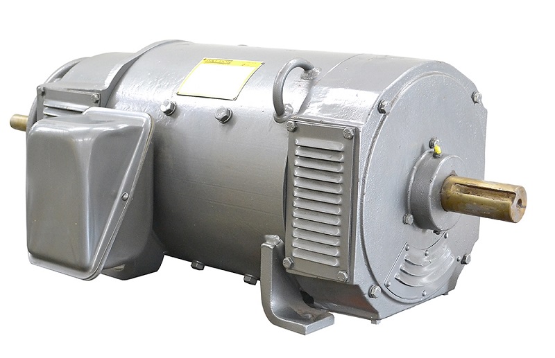

One of the main stated benefits of a DC motor is the performance at low speeds. They can certainly be driven at high speeds as well, but if a load must continually adjust speed quickly, or it requires superior torque at a low speed (perhaps taking a long time to accelerate), the DC motor may be the preferred choice.
Large Baldor motor
Figure 2. Large industrial 500 volt DC motor. Image used courtesy of Baldor
Reducing speed is accomplished by either reducing the voltage, or more commonly, by applying a pulsed full-voltage signal, called pulse-width modulation (PWM). DC motors are also easy to switch directions because of lower rotating inertia when supply leads are reversed.
This low-speed torque characteristic is due to the current allowed through the armature. When rotating at a low speed, the brushes will be in contact with an armature for almost half of the motor’s rotation, providing full current for half of the motor’s rotation in each direction. Contrast this with the typical AC signal, where the voltage only spends a moment at full positive or full negative before reducing to alternate once again. At high speeds, the rapid transition time of the AC signal is more comparable to the rapid transition of the brushed DC signal.

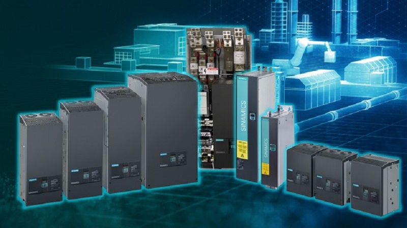

Siemens produces its series of Sinamics DCM drives that are fully integrated into their programming software, TIA Portal. Allen Bradley and Rockwell Automation offer their PowerFlex DC drives which also interface with their programming software. With these particular drives you only need to connect them to the machine network and the PLC will be able to communicate over the network.
Inside the programming software, simple data structures are supplied to start, stop, and change motor speed, along with many other control and feedback parameters, just as with VFD motor controls. These drive units can get quite large and will require substantial cooling inside of the cabinet for large-current applications. They are typically mounted to the electrical cabinet backplane and connected to the supplier Fieldbus communication technology.
There are also simpler solutions on the market that offer non-networked speed and direction control via switches and dials or some may even accept analog and digital inputs for speed and direction.
