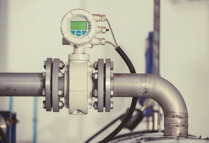

Pressure and flow process sensor
Figure 1. At a basic level, both SCADA and DCS are designed for controlling and optimizing industrial processes in plant systems. Image used courtesy of Adobe Stock

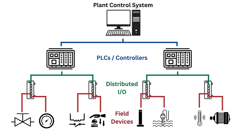

DCS architecture
Figure 3. Example of DCS managing a local factory automation system. Image provided by the Control.com Engineering team
