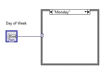

The bar along the top can toggle between cases or select a case to code. The “?” terminal is where the selector criteria input is connected. Notice that once this is connected, the case structure populates with a few cases. To add all possible cases, right-click on the edge of the case statement and select “add case for every value.”
Figure 2. This case has been fed an enum with a list of days of the week. The case structure is auto-populated so that each day has its own case.
Notice that one case is listed as the “default” case. The default case is the case that gets selected if no inputted value matches any of the cases. Every case structure requires a default case, and the programmer can pick one.

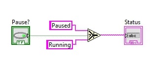

Select? structures take one boolean input signal and use it to pick one single output. Therefore, any time the programmer needs to control the output of one signal based on one single input, the select? structure is the best choice. It has less programming overhead and executes much faster than the case structure.
For example, a certain VI needs to send a simple status string that says “paused” or “running” to a display. A boolean input can determine this, and the output is simply one string or the other.
Figure 4. Select? structure deciding between two different strings.

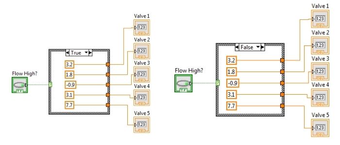

Another example in favor of case structures would be when a routine has to do multiple things based on one decision. Suppose a VI must send control signals to multiple valves based on feedback from a flow meter. A comparison is made between the flow rate and a set point, and a boolean is fed into the case structure. The case sets the proper valve position for every valve, each of which will have its own output from the case structure. This would be difficult to do with select? structures.
Figure 5. True/false case statements.
A case statement outputs different values to five valves, depending on the flow rate status (flow high?). They are the same piece of code, but displayed twice to show the difference between the true and false cases.
