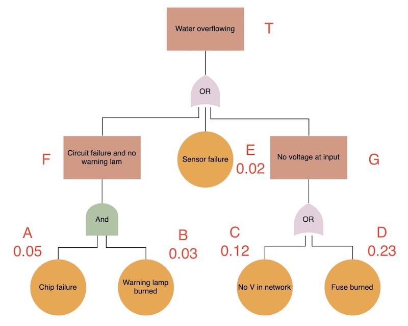

Consider a simple control system that controls the function of a motor control circuit that automatically cuts off the motor when the water tank is full. A potential system failure is an overflowing tank leading from the motor control system not working.
How to Create Fault Tree Analysis (FTA)
A simple fault tree for such a scenario is given below.
Fault Tree Analysis (FTA) example
Figure 1. Fault tree diagram for simple motor control.
The top event is represented as T. We will analyze the fault tree for a failure event in which water is overflowing.
A, B, C, D, and E are the basic events. These events occur spontaneously and could be the root cause of the problem.
F and G are intermediate events. This means they are caused by logical interactions of some basic events or other intermediate events. The different logical relationships will lead to the potential failure—the top event, T.
Some numbers are given along with basic events. They represent the probability of the failures to occur. The basic events A, B, C, D, and E are failures of one or the other, and the probabilities are provided alongside them.
It is pretty clear from the image how the logical relationships between the various events function. Only if event A and event B occur, the intermediate even F will occur. But if event C or event D occurs, event G will occur.
The top event, T, is connected to other intermediate events and a basic event through an OR gate. This means if any of the one events among E, F, or G occur, the top event failure will occur.

The probabilities of each intermediate event and the top event can be calculated using the probabilities of the basic events provided.
P(F) = P(A AND B) = P(A) * P(B)
P(F) = 0.05 * 0.03
P(F) = 0.0015
Similarly, one can find the probability of the intermediate event G. Here, C and D are disjoint events.
P(G) = P(C OR D) = P(C) + P(D)
P(G) = 0.12 + 0.23 = 0.35

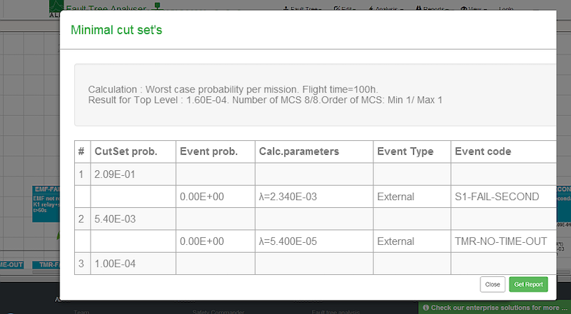

Figure 2. Fault tree reports are probability statistics are available in ALD. Image used courtesy of ALD
Once we find the probabilities of E, F, and G, we can calculate the probability of the top event occurring. Here, E, F, and G are also disjoint events.
P(T) = P(E) + P(F) + P(G)
P(T) = 0.02 + 0.0015 + 0.35
P(T) = 0.3715
The overall probability of a system failure occurring and tank overflowing is 37.15%. Using the fault tree and the probabilities for each event, we can analyze how to reduce the chance of failure.

From the calculations above, we can see that the intermediate event G is the largest contributor to the chance of system failure. Reducing the probability of occurrence of G will significantly reduce the overall chance of the top event from occurring. From the fault tree, we can see that G is connected to the basic events C and D through an OR gate. To reduce the chance of occurrence for G, the probability of events C and D have to be reduced. This will, in turn, improve the reliability of the complete system.

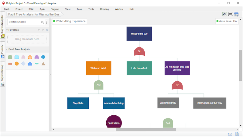

Figure 3. An example diagram made in Visual Paradigm. Image used courtesy of Visual Paradigm
Visual Paradigm is a company dedicated to building various drawing tools for different industries. The company has dedicated software to conduct fault tree analysis, and its tool has an interactive and intuitive interface. The result of drawing the fault tree can be saved and stored in multiple formats. The added advantage is that it integrates well with other visual tools from the company.
