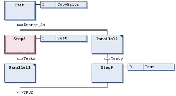

Using a similar approach to FBD programming, you want to make sure blocks and transitions are spaced out as much as possible and use comments when necessary. With SFC, you can add parallel branches, but exercise caution with this practice. If you add too many branches, the diagram can become cluttered and hard to read.

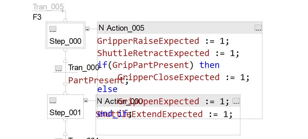

Essentially, best practice dictates working to make the diagram look neat and tidy. If wires are in the way, they are likely to be hidden, so reference arrows should be used. Make sure step actions don’t overlap with transitions or other steps.
Figure 3. Improperly spaced text and layout (intentionally exaggerated for effect).

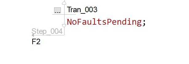

  2. Create a logic rung outside of the SFC that sets a single bit used on every transition. Typically I like to use an all-sensors OK bit or monitor a fault word. If any fault is pending I know that the sequence needs to wait. By using a single bit for every step, you reduce the complexity of the SFC program and remove processing to another subroutine.

Figure 4. Parallel SFC branching.

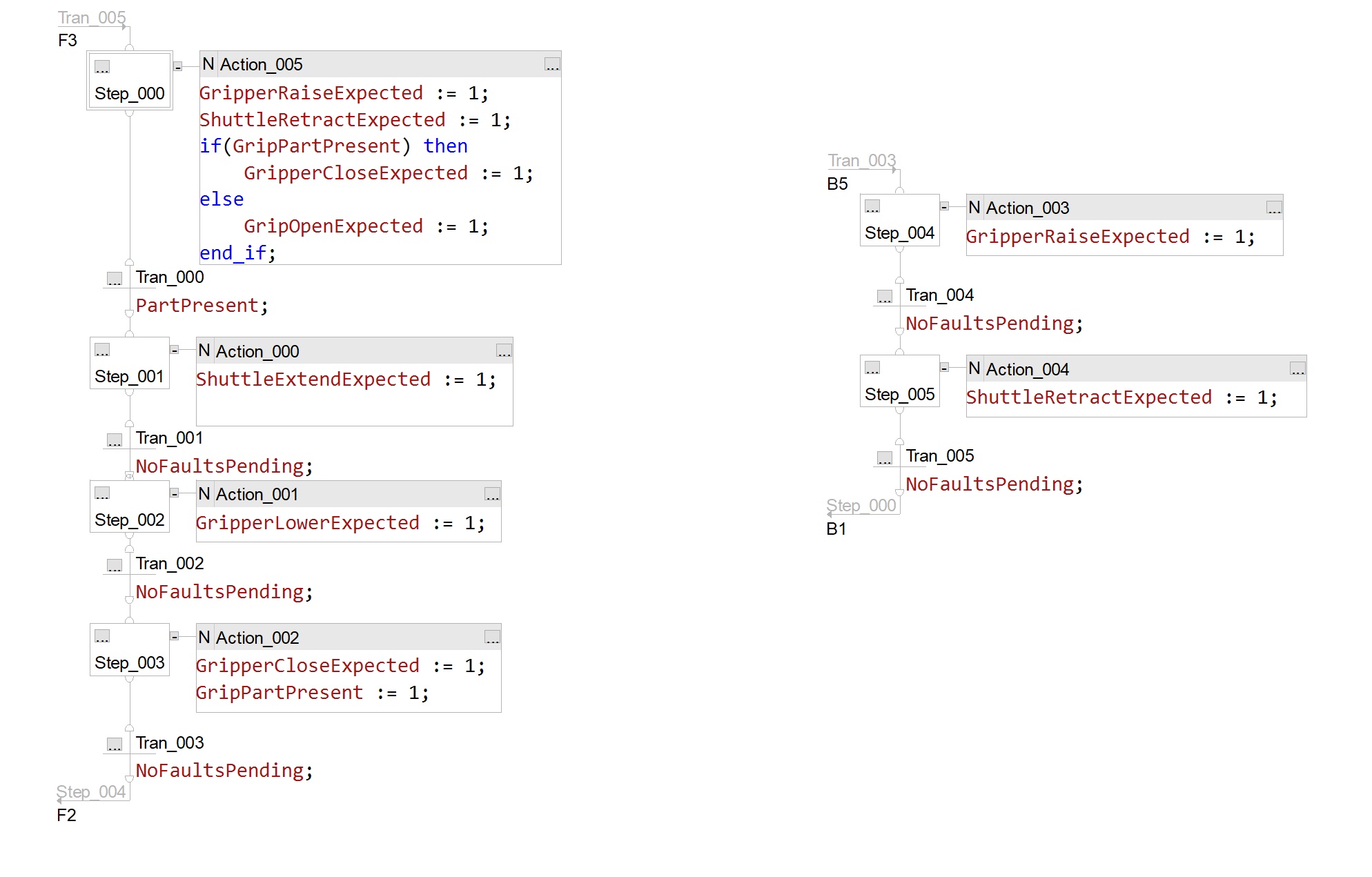

If we refer back to our pick-and-place station example we would need to create a SFC for the three pneumatic cylinders and another SFC for the escapement. Each cylinder, gripper raise/lower, shuttle extend/retract, and gripper open/close, would all have faults if the sensors are not in the correct position with respect to their expected state.

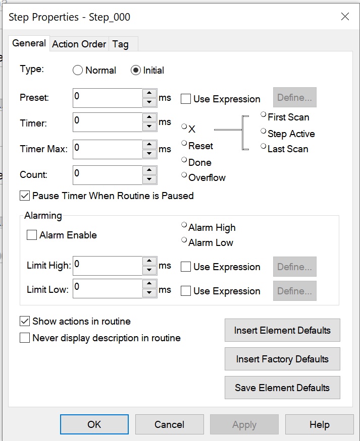

After that, it is highly recommended one monitor the fault word. If there was any fault pending it is best to prevent the step forward in the SFC. To accommodate a step delay, some IDEs offer timers built into the SFC step. With Rockwell Automation’s Studio 5000, each step has parameters that can be set including a step timer.  When a part is present and the escapement is in the pick position, start the pick-and-place SFC.
Each step of the SFC would set a different expected state for the cylinders, these expected bits are our handshakes. As the expected state changes a fault would be pending until the cylinder reaches its position, then the sequence would step forward.
