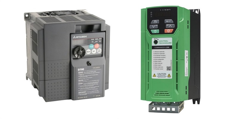

Figure 1. Two VFDs including models from Mitsubishi Electric and from Control Techniques.
