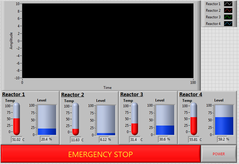

Figure 1. LabVIEW front panel monitoring four reactors.
Figure 1 shows a front panel monitoring four reactors. There is a big “emergency stop” button, a power button, and a waveform chart for displaying the temperatures. While the temperatures are displayed in ℃, the tank heights are in percent. Percents, arbitrary values, and a combination of color-coding and text can be used to protect proprietary quantities.

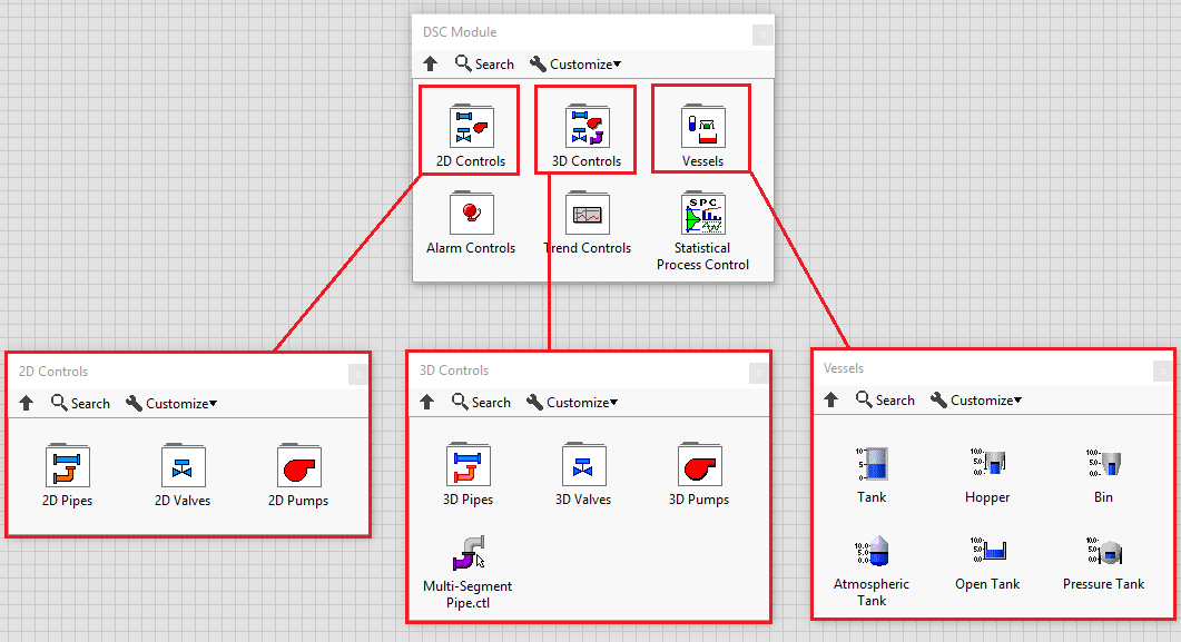

Figure 2. A screengrab of the Data and Supervisory Control (DSC) module in LabVIEW. Image used courtesy of National Instruments
Figure 2 shows the DSC module allows for more controls and indicators, some of which will be similar to chemical engineering piping and instrumentation diagram symbols or pipes and physical devices that the operator will recognize.

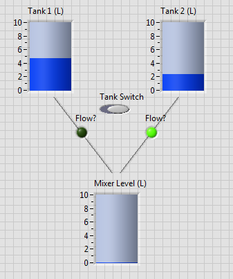

Figure 4. A LabVIEW VI showing two tanks feeding a mixer.
In figure 4’s example, one of two tanks feeds a mixer. Instead of pushbuttons, a slider switch indicates which tank is in use. Also, notice the two LEDs labeled “Flow?”. At a glance, an operator knows which tank and pipe system are feeding the mixer.

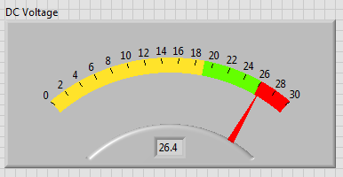

Figure 5. DC voltage gauge on a VI’s front panel.
Instead of displaying just the voltage and changing the color of the text, the gauge in figure 5 gives a visual cue of the acceptable range. The vision-impaired operator can see the needle moving to the right side of the graph when there is a problem.
