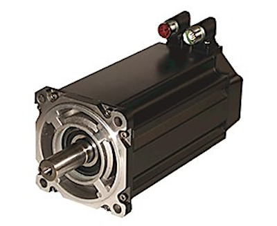

Rockwell Automation servo motor
Figure 1. Servo motors such as the one shown are well-suited for fuzzy logic control. Image used courtesy of Rockwell Automation
Fuzzy logic can be used in various control scenarios, including servo motors. Servo motors are an essential part of motion control systems related to industrial automation and process control. Because of this, servo motors serve well as an example of developing an FLC.

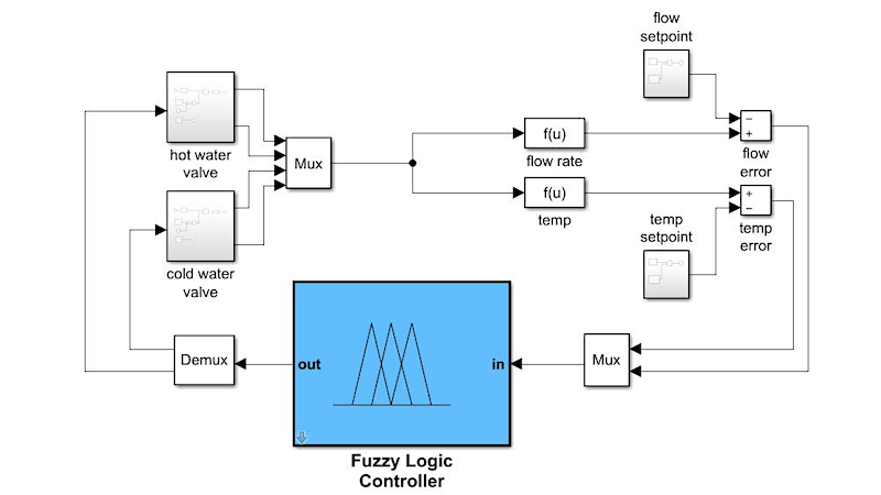

There is no right or wrong approach, similar to preferring ladder logic over structured text. But, for the basis of this article, we will use Mathworks Simulink. Mathworks provides a Fuzzy Logic Toolbox and a Fuzzy Logic Controller block, as illustrated in figure 2.
Mathworks Simulink Fuzzy Logic Controller
Figure 2. Mathworks Simulink supports control system development, including fuzzy logic control. Image used courtesy of Mathworks

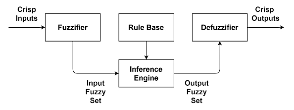

FLCs have a fuzzy logic inference system at their core, like the one shown in figure 3. The primary difference is what constitutes the inputs and outputs.
basic fuzzy inference system
Figure 3. Basic fuzzy inference system.

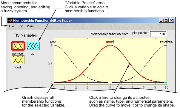

The following must be selected and configured for the position error and change in position error inputs. Figure 4 shows an example of how much of this can be accomplished through the Mathworks Fuzzy Logic Toolbox.
  • Normalization factors to ensure the input to the fuzzifiers fall within the range of the fuzzy membership functions.
  • Fuzzy membership functions and their configuration.
  • Linguistic identifiers representing fuzzy membership.
Fuzzy Logic Toolbox in Mathworks Simulink
Figure 4. The Fuzzy Logic Toolbox visual membership function editor can customize membership functions for different variables (command line editors are also available). Image used courtesy of Mathworks

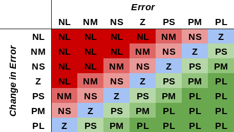

A fuzzy rule table, such as the one shown in figure 5, can be helpful when there are a limited number of inputs and outputs. In figure 5, the two inputs are “error” and “change in error.”
The columns in the table represent the linguistic labels used for error, while the rows represent the labels used for change in error. The values in the center of the table are the fuzzy form of the PWM output.
fuzzy rule table for servo motor control
Figure 5. Example of a fuzzy rule table for servo motor control with two inputs (error and change in error) and one output (PWM).
The Matlab Fuzzy Logic Toolbox offers a fuzzy rule editor that would work well with a fuzzy rule table. In addition, rules can be visualized in two ways: (1) a 2D graphical representation of all the rules in the rule base known as the Rule Viewer, and (2) a Surface Viewer that illustrates how mapping takes place for the rule base.

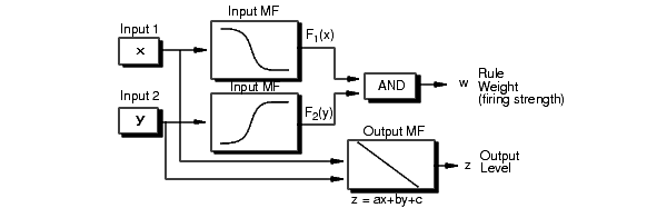

Sugeno FIS
Figure 6. How the Sugeno FIS generates output. Image used courtesy of Mathworks
The Sugeno (or Takagi-Sugeno-Kang) FIS, on the other hand, is more adapted in control systems because it results in a continuous output surface and is more computationally efficient due to not using a fuzzy output membership function (illustrated in figure 6).

  • P
    pnachtwey January 31, 2022
    I see now sum of errors.  When dealing with rates. like flow, there needs to be an integrator.
    I have seen this problem in Fig 2 before.  It can be solved with two Pi controllers.  LQC can also be used but turns out to be essentially to PI controllers with the gains computed by the LQC function that minimize the ‘cost” function.  Where is the FLC,s cost function.  Also, fig 5 looks linear.  Using linear gains is simpler.
