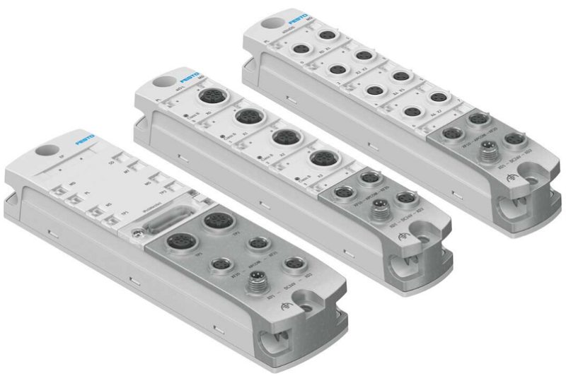

Distributed I/O can be added into many projects
Figure 2. Distributed I/O devices, with consistent tag layouts and terminal quantities, can speed up the development of a system. Image used courtesy of Festo
Common Inputs and Outputs for PLCs
Every project will have some kind of input and output, no matter the type of control system being used in the project. Thanks to fieldbus technology like Ethernet/IP, PROFINET, and EtherCAT, mapping I/Os has become a simple and easily repeatable process.
Some companies like to standardize the type of remote I/O used on projects so that the design can simply be copied and pasted into the new project. With PLC code, that is not always possible. For I/O, it’s best to target the popular fieldbus technologies and have a couple of examples that can be referenced.
Whichever remote I/O you are using, it is best to map the inputs and outputs into a user-defined data type. This makes it easy to reference the usable inputs and outputs by name rather than by address. With Allen-Bradley (Rockwell) PLCs, the Ethernet module tags can be copied into a tag provided that the user-defined data type (UDT) is the same size as the source tag. This method maps the I/O with one instruction, and UDTs can be created from Microsoft Excel.
Some systems can have hundreds, if not thousands, of inputs and outputs, so developing a standard way to map those tags to usable tags will greatly reduce the amount of time you spend in development.

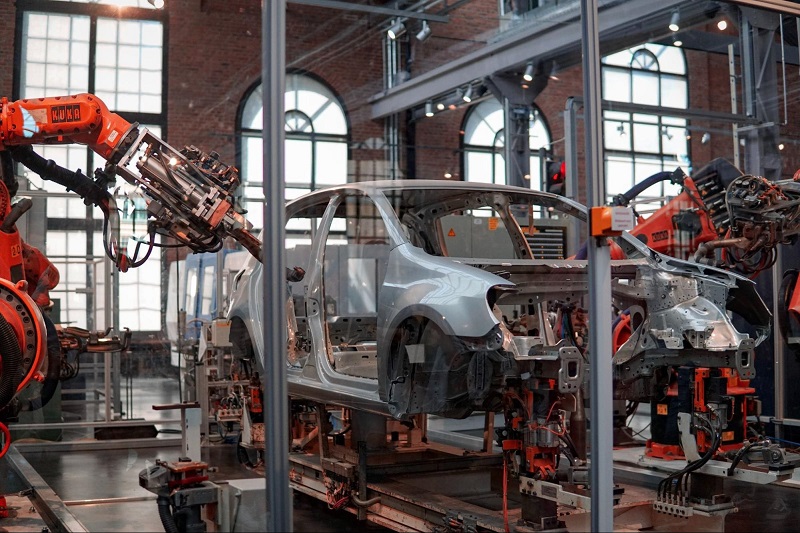

Robotic integration into PLC systems requires pre-planning
Figure 3. Large machine centers, with robots, controllers, and many I/O devices, require careful attention to detail in order to standardize any process. Image used courtesy of Unsplash
