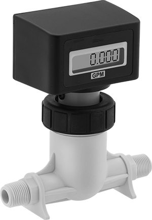

GPM meter, or flow totalizer with digital display
Figure 2. A washdown totalizer for water. Image used courtesy of McMaster-Carr

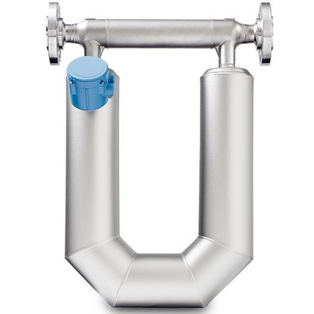

While this meter style is accurate, it is expensive and requires specific pipe layout requirements. For example, the Coriolis flowmeter requires space for a U-shaped section of pipe.

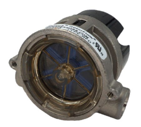

As mentioned above, a flow totalizer connects to a flow sensor and reads the pulses to calculate the total flow in an hour, day, month, or running total. Typically, a totalizer is a standalone product that displays the amount of fluid that has passed by the sensor.
Flow totalizing device with pulse output
Figure 3. This rotor flow sensor features a VDC pulsed output. Image used courtesy of Gems Sensors [PDF]
By taking a reading each day and subtracting the difference, you can easily calculate the amount of product consumed each day. Or, some totalizers can be configured to reset after a specific amount of time.

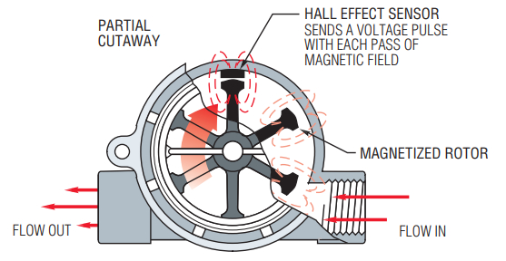

A flow sensor is mounted inline of the flow and pulses a signal every time a specific amount of fluid has passed by it. A typical flow sensor will consist of a magnetized or magnetic paddlewheel.
Operation of flow totalizer
Figure 4. The operating principles of how a hall effect sensor is utilized in flow sensors. Image used courtesy of Gems Sensors [PDF]
As fluid pushes the wheel, the paddle is sensed, and the sensor sends out a pulse. These sensors will often have hall effect sensors to detect the magnetic field disruption as each paddle passes.

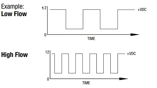

If your sensor uses a pulsed output, an extra calculation is required. A pulsed output will have a frequency; this frequency will change as the flow increases or decreases, but there should be a max frequency relating to the max flow.
Frequency to analog signal conversion principle
Figure 5. How frequency output signal looks in graph form. Image used courtesy of Gems Sensors [PDF; Note: the top graph fixed to 0–12 on the Y-axis]

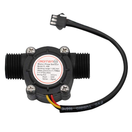

I used an inexpensive flow sensor from Amazon to measure the amount of water entering a tank. The PLC was an Allen-Bradley Micro820 with no high-speed counter option installed and a scan time of 4 ms. The flow sensor was a DIGITEN FL-408 pulsed output with a max flow of 30 L/min.
Small digital flowmeter
Figure 6. The flow sensor that I used from Amazon. Image used courtesy of DIGITEN
The flow sensor datasheet provides a formula of F=7.5*Q. This formula tells me at 30 L/min, I can expect a frequency of 225hZ. At 225hZ, I can expect a period (one cycle of the signal) to be 4.4 ms (1/225).
Instead of purchasing the high-speed counter option, I decided to try using the standard analog input. I connected the sensor output to the analog input and used a “greater than” function block to drive a counter. Anytime the input was greater than zero, I would increment the counter.
After one second, I would capture the counter value and calculate the flow in L/sec, so I have a new flow rate every second. I then use this flow rate to calculate the total volume for one second and add that to the previous volume.
Sadly, this didn’t work very well.
The flow rate fluctuates too much during the one-second calculation time, and I believe I’m missing some pulses. Despite the data not being 100% accurate, it works for a rough measurement of total volume. You can still use the total volume to make some minor decisions.

The flow sensor I’m using also doesn’t support 24 VDC, so I used a 24 VDC to 5 VDC converter and the analog input to the PLC. If I used a 24 VDC sensor with a high-speed input, I’m sure I could get a more accurate flow rate measurement and total volume calculation.
