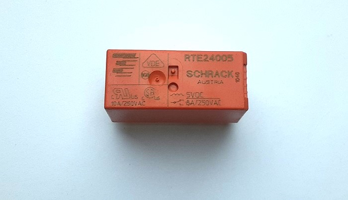

Figure 1. A small electromechanical relay designed for 5 volts DC input and meant to be mounted into a printed circuit board.

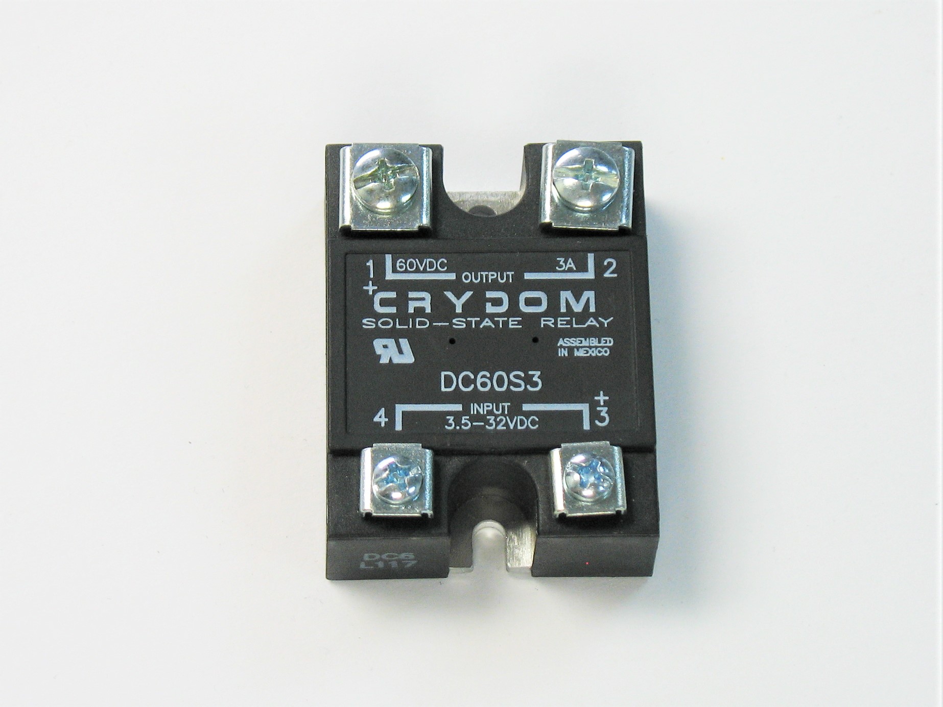

The basic structure of the relay is the same, regardless of whether it’s mechanical or solid-state. A control voltage is applied to the ‘coil’ side of the device, and once energized, a number of contacts open or close to either turn on or off a load device circuit.
Figure 2. A typical Solid State Relay. This relay is designed for 3.5-32 volts input, which is fairly normal, but should only be used with a DC load device, up to 60 volts at 3 amps of current.

The mechanical relay uses a specifically rated AC or DC voltage for the coil input, and it can vary from 3.3 V on computer circuits up to 24 V in DC, or from 24 V up to 120 V or higher AC supplies. Each relay operates with one single voltage only. To use two voltages means you must have two separate models of the relay.
The solid-state relay accepts DC inputs, usually in a wide range of inputs. Anywhere from 3 to 32 Volts is usually a common range, and a single SSR may be installed for any control voltage within this range.

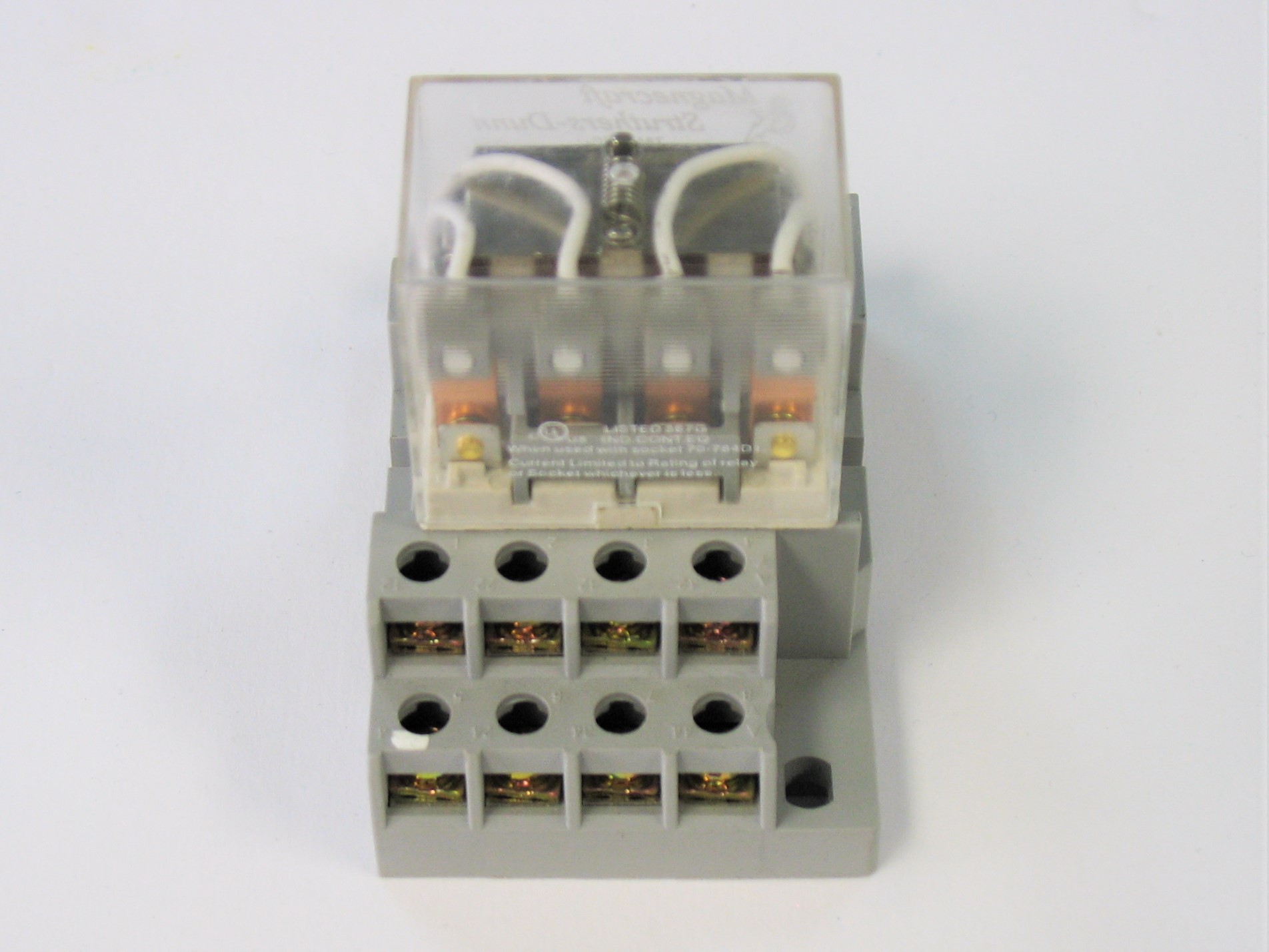

The mechanical relay always includes one or more sets of physical contacts that open or close as the magnetic field is applied from the coil.
The most common is for each contact set to include a common power terminal, and separate terminals for a normally open (NO) contact, as well as a normally closed (NC).
This is called double-throw. There may be one, two, or four contact sets (called Poles), but other variations can be found. This leads to naming conventions such as single-pole double-throw (SPDT), or double-pole double-throw (DPDT), etc.
Figure 3. The four copper tabs on this larger mechanical relay display the construction of a 4-Pole Double-Throw (4PDT) relay model.

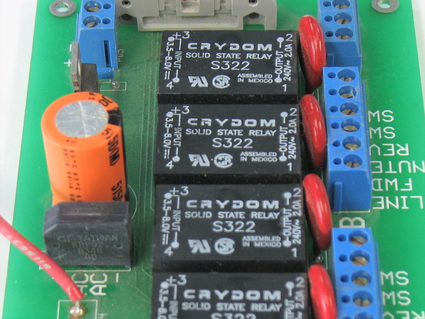

An important fact about the SSR construction is that on the output side, it may consist of either a high-power Field-Effect Transistor (FET) or the TRIAC. Either device may be switched using photo-sensitive components, but each has a specific purpose.
The FET is designed for DC loads only, it will not allow an AC load to activate. Likewise for the TRIAC, since these devices operate using AC waves, it will only properly activate and deactivate an AC load.
If using a solid-state relay, look at the contact side, and pay attention to the voltage, the current, and also the important point of either AC or DC load switching.
Figure 4. A printed circuit board with an array of solid-state relays. Each relay is designed to switch an AC load (indicated with the ~ symbol), up to 240 volts with no more than 2.0 amps of current.
