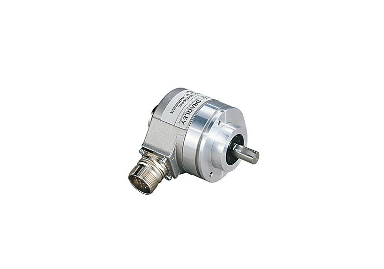

Multi-Turn Magnetic Absolute Encoders
Allen-Bradley Multi-Turn Magnetic Absolute Encoder. Image used courtesy of Allen-Bradley.
In applications where more accuracy and a larger range is necessary, a multiturn encoder uses gear reduction and two encoder disks to enable a larger band of known positions.  Absolute encoders are more applicable to situations where position data is required after a power shutdown, the most common being in a safety circuit.
Incremental encoders have evenly spaced slots to send pulses to the controller. These encoders rely on pulses that are counted from a zero location, so it is important to have a known position to restart the count in the event that the system loses power for any reason.

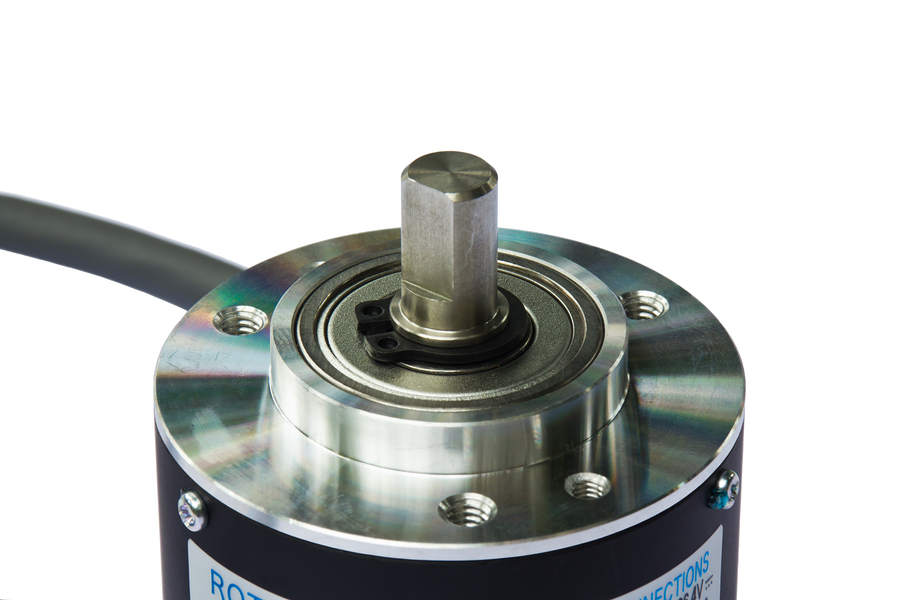

The Use of Rotary Encoders
Rotary encoders consist of a round-shaped scale attached to the shaft of a motor. As the motor turns, the light sensor reading the pattern in the scale sends either pulse counts or binary code to the PLC.
A rotary encoder is useful in applications where motor speed is needed or where it is difficult to measure distance by a means besides the rotation of the motor, such as in the servo motors in a robotic arm.
rotary encoder
A close up of a rotary encoder.
Applications that need motor speed control use incremental encoders that produce pulse counts to measure motor speed. There are a certain number of slots in the encoder scale and the PLC counts the slots as the motor turns. This can then be translated into RPM. An example of where this might be useful is on a conveyor belt motor. Certain parameters might call for different belt speeds, and the PLC can adjust accordingly, based on the RPMs of the motor.
They are also useful in applications where accuracy is important because they produce much more accurate data than absolute rotary encoders. Although they are more accurate, they are not able to read positions without some movement and may possibly need a reference position after loss of communication with the PLC.
Absolute encoders are also available for rotary-style motor encoders. These are more applicable to situations where angle data is necessary. They are also able to recall positions after the loss of communication or power between the encoder and the controller, unlike the incremental rotary control which needs movement to relay data.
