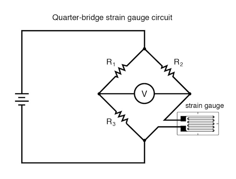

Strain Gauge Signal Conditioning
Strain gauges are used to measure force. Its resistance changes as the power is applied to the sensor. Using additional components allows measured force to calculate other variables such as weight and pressure. The strain gauge is used in combination with a circuit called Wheatstone bridge. It consists of four resistive elements having known resistance. The strain gauge can be placed in any of four positions.
quarter-bridge strain gauge circuit
Figure 2. A quarter-bridge strain gauge circuit.
The signal conditioning circuitry should provide the power source to the bridge, called excitation voltage. According to specification, the excitation voltage should be stable, as the bridge output depends on the excitation voltage. Therefore, if the excitation voltage is not stable, the result will also fluctuate and produce non-stable readings.
The signal conditioning circuitry should amplify the strain gauge signal because strain gauge sensors output is small, typically in millivolts (mV) per excitement voltage. The signal conditioning circuitry amplifies the signal level to prevent noise and increase resolution.
The signal conditioning circuity should provide provision for balancing the bridge and reference resistive elements. It should also offset the output values in case of no strain signal; there is often no strain on the sensor, but the circuitry generates a small voltage. This small voltage produces an output indicating a false value.

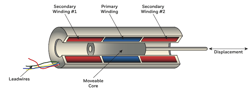

Linear Variable Differential Transformer (LVDT) Signal Conditioning
A linear variable differential transformer (LVDT) measure linear displacement. It works on the principle of the transformer, having coil and core. The coils are stationary, while the core is moveable. The core is attached to the object for which position is measured.
Figure 3. Cutaway view of an LVDT. Image used courtesy of Honeywell [PDF]
Since LVDT works on the principle of the transformer, it involves a sinusoidal signal. Therefore, signal conditioning circuitry should calculate the magnitude and phase of the alternating current (AC) signal. The magnitude calculates the displacement value and phase to calculate the direction of movement.
The excitation source for LVDTs is the AC signal for the primary coil. The secondary signal is demodulated with the primary signal. The demodulated or direct current (DC) signal represents the actual displacement that occurred. The DC polarity indicates the direction of displacement.
