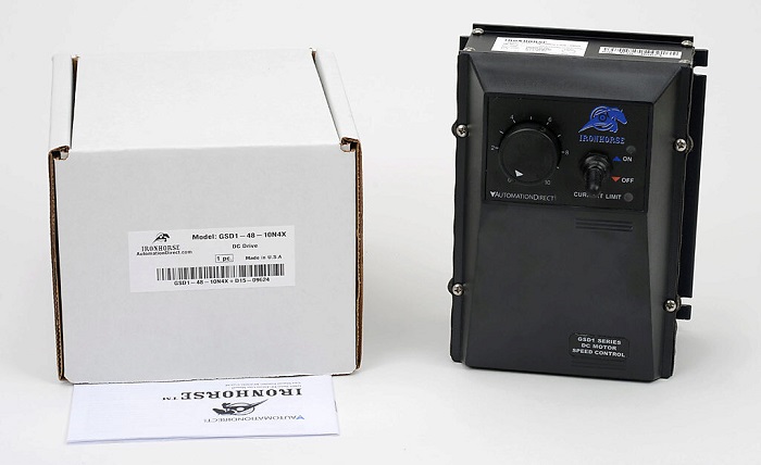

DC Motor drive unit
Figure 1. A DC motor drive with a PWM output and a NEMA-enclosed frame. Image used courtesy of Automation Direct

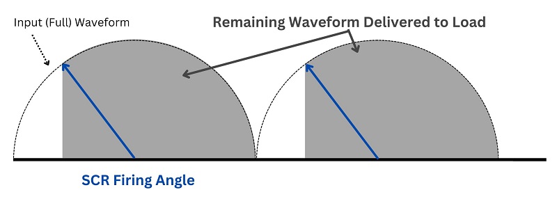

An SCR is a solid-state device with three parts: an anode, a cathode, and a gate. It works like a diode, letting electricity flow in one direction (from anode to cathode), but only when a trigger voltage is applied to its gate. Once triggered, it stays conducting even if the gate signal is removed until the positive voltage at the anode stops. When used to convert AC to DC, the SCR is turned on during the positive part of the cycle. Then, as the voltage reaches 0 at the end of the positive cycle, the SCR switches off.
The timing of the trigger signal determines the firing angle, which is the exact point in the sine wave at which the SCR turns on. When it's turned on, electricity goes to the motor winding. The firing angle also affects the average voltage and the output speed. If fired early, electricity goes to the windings for longer, and the average voltage is higher.
Firing angle for an AC waveform
Figure 2. This image clarifies the "firing angle" concept in SCR controls. Image used courtesy of the author

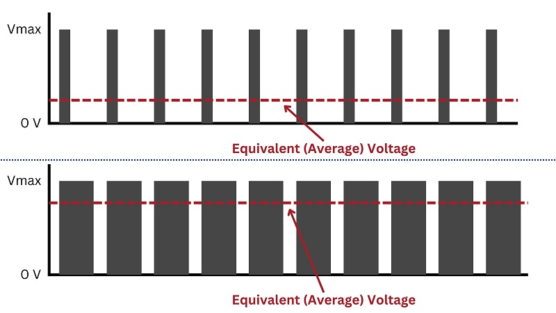

In PWM circuits, a transistor or SCR is used to control voltage. When the transistor turns on, electricity flows through the motor. The timing of when the transistor/SCR starts and stops conducting (called the duty cycle) decides how much average voltage goes to the motor and how fast it moves. If we widen the pulse, more voltage goes to the motor on average, making it move faster.
PWM speed control
Figure 3. This image clarifies a PWM control circuit and how the pulse width determines the average voltage. Image used courtesy of the author

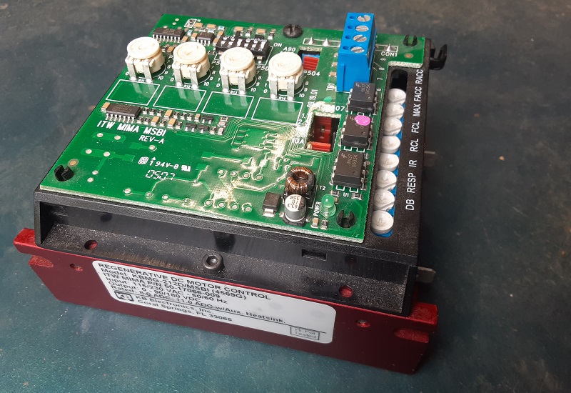

Open Frames
Choose open frames when your motor operates in a clean, dry setting with minimal exposure to contaminants, moisture, or harsh elements.
Benefits of open frames:
  • Cost-effectiveness: Open frames are typically less expensive than NEMA enclosed frames due to their more straightforward build.
  • Adequate ventilation: Open frames offer ample ventilation to maintain motor temperature in environments where cooling isn't a significant concern and contamination risk is low.
  • Space considerations: Open frames' compact design makes them a favorable option if space is limited.
DC Motor speed control
Figure 4. This DC motor controller has an open frame. Image used courtesy of the author
NEMA Enclosed Frames
Select NEMA-enclosed frames for applications where the motor faces moisture, contaminants, high humidity, or other harsh conditions that could compromise its performance and longevity.
Benefits of NEMA-enclosed frames:
  • Enhanced protection: NEMA enclosed frames offer superior safeguarding against moisture, dust, and various environmental factors, ensuring prolonged motor lifespan and reliable operation.
  • Safety compliance: NEMA enclosed frames are required in industries mandating enclosed motors for personnel and equipment protection.
  • Versatility: NEMA enclosed frames are available in various types tailored to specific environmental challenges (e.g., TEFC, TENV, WPI, WPII). These frames provide flexibility to match the enclosure to application needs.
