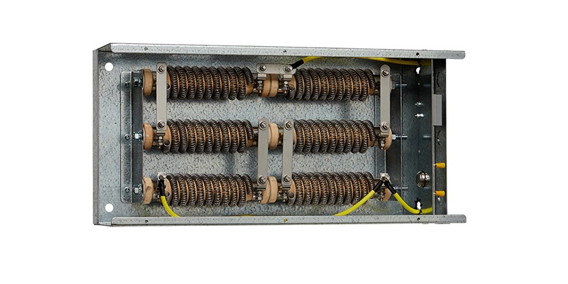

Braking Resistor
Figure 1. Internal view of a braking resistor. Image used courtesy of Fortress Resistors

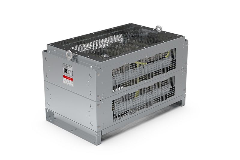

Floor mount resistor
Figure 2. Large floor-mount braking resistor. Image used courtesy of Fortress Resistors

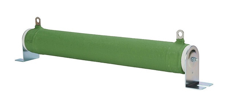

Ceramic brake resistor
Figure 3. Some braking resistors do not need to be quite as large - smaller mass, velocity, and stipping rate can make a difference. This one is ceramic. Image used courtesy of Automation Direct
