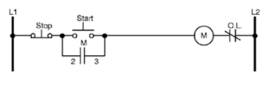

Combining Symbols - Electrical Schematic
Sometimes these symbols are used individually, and sometimes they are combined. Below is an example of a motor control schematic.
typical 3-wire latching control for motor start/stop logic
Figure 2. Typical 3-wire latching control for motor start/stop logic.
Figure 2 shows a start push button that is normally open, a stop button that is normally closed, a motor contactor with auxiliary contact, and a motor overload.

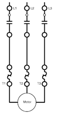

typical direct contactor/starter arrangement for driving a three-phase motor
Figure 3. Typical direct contactor/starter arrangement for driving a three-phase motor.
Figure 3 is a schematic of a three-phase motor showing three contacts, three overloads, and a motor.
The first schematic could be used to control the motor. If the stop button is not pressed and the start button is pressed, the “M” coil will energize, closing the contacts on L1, L2, and L3. An auxiliary contact is used to “seal in” the start button condition. If the stop button is pressed or the overload tripped, the coil will de-energize, opening the contacts.
