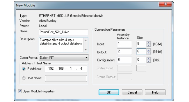

In this example, we’ll discuss a Rockwell PowerFlex module, with the information provided being applicable to any controller, from any manufacturer with an Ethernet-capable port. This information is pulled directly from the product user manual (starting on page 55 for specific reference), as it should be with nearly any device.
Generic Ethernet setup with data type, assembly instance, and size information.
Figure 1. Generic Ethernet setup with data type, assembly instance, and size information.
As we can see from the image in the Studio 5000 software Generic Ethernet Module setup, the following information is required:
  • Comm (data type) Format, which may be 8, 16, or 32 bits.
  • Assembly Instance, which must be provided by the manufacturer for I/O and Config information
  • Size refers to the number of data types that are required for proper communication. They must be included, even if the value is zero.
Knowing this information, I could install this VFD on any networked controller with a generic Ethernet capability.

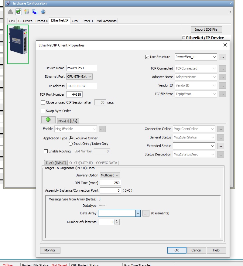

In a second example (Automation Direct), showing a slightly different set of input panels, I can add a message for I/O information. It asks for an assembly Instance, data type, a name for the tags (Data Array), and a number of elements. As we saw previously, we have this information from the user manual, so using this VFD with this PLC is not too difficult.
Ethernet module entry for an Automation Direct PLC.
Figure 2. Ethernet module entry for an Automation Direct PLC.

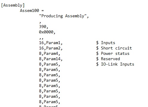

The good news here is that you really don’t need to understand all of this. It should not be edited. But if you want to get a quick glimpse of what’s inside an EDS file, here is an example:
Extract of EDS file text.
Figure 3. Extract of EDS file text.
This is the text editor view of the tabulated data for one of the parameters which can be shared between devices.
Remember when we created the Generic Ethernet Module? We could assign a number of bytes or integers to the Input data array, but we really had to guess or discover what each one of those meant. For a VFD, one should turn it on, one should assign the direction, yet others should command the speed, but we would have to manually locate those parameters and assign the descriptive names.
In looking at this parameter, we can see a data type (hex coded), a data size of 1 byte (8 bits), and a name.
When a new IO-Link hub device is created in my project using this EDS, I will look into my tag database and expect to see a single tag, one byte (or SINT) in size named ‘Power status’. Most likely, we would assume this to be a value of either 0 or 1, but it may also contain fault codes.
Isn’t that nice—we don’t need to discover the task of each input and output byte. Good news, because there are a LOT of them.
390 of them, to be specific. Some are grouped into sets of 16 bits which use two 8-bit bytes, but there are 390 bytes, just in the “Input” assembly. Take a look at Param4 below. This is the same Parameter 4 we saw in Figure 3, the ‘Power status’. Most are reserved for the IO-Link Input Data, as expected.
