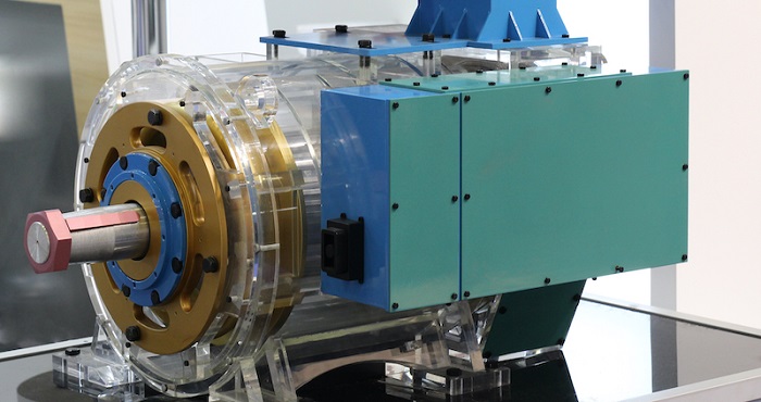

Resolvers and encoders identify the physical operating characteristics of equipment in operation. Generally, they measure the speed, the position of the shaft, and the direction of rotation. They are used in conjunction with AC and DC motors and provide real-time feedback of the machine in operation to the controllers using hardware connections. This feedback is used to adjust the power delivered to the motor to obtain the desired operating characteristics of the machine.
Resolvers and encoders are used to obtain operating characteristics of AC & DC motors.
Figure 1. Resolvers and encoders are used to obtain operating characteristics of AC & DC motors.

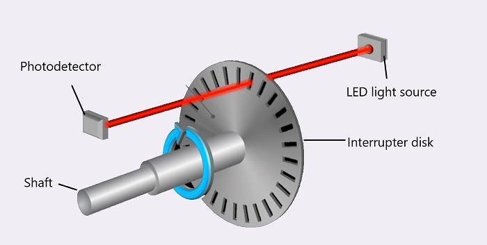

Figure 2. Diagram of a rotary encoder using an optical sensor. Image courtesy of Ryan VanOtterloo.
The image above represents a typical rotary encoder using optical sensors. The encoder shaft is coupled with the shaft of the motor to be sensed and is fitted with an interrupter disk which has evenly spaced cutouts along its periphery.
An LED light source emits a beam of light through the disk to the photodetector placed on the other side of the interrupter disk. When the disc rotates, light passes through the cutouts on the disk and is blocked in the areas where there are no cutouts. The photodetector measures light with a high or low voltage— a high voltage represents the time when the LED light hits the detector, and a low voltage represents the time the LED is interrupted by the disc. The digital output can be used to calculate the speed and angle of rotation from the starting position. The direction of rotation cannot be determined using a single interrupter disk.
Two-track interrupter disks can be used to determine the direction of the shaft. The disk will have two tracks: track A and track B. Each of the tracks have a respective LED light source and photodetector. Tracks A and B are offset from one other. This offset causes the signal measured by photodetector A and B to stagger.
According to whether the rising edge of track A or track B leads determines the direction of the shaft rotation. Disks with a greater number of tracks can be used for better resolution of the measured value. Having more tracks increases the accuracy and precision of the encoder. Having a higher number of tracks also enables absolute measurements rather than incremental measurements.

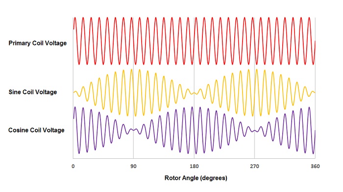

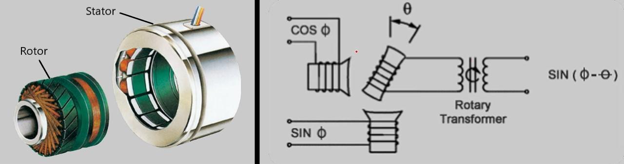

Resolvers are rotary transformers that provide analog output as cartesian coordinates of the angular position of the shaft. This information can be converted to speed, angle, and direction of rotation. The output of a resolver is two analog signals — one is proportional to the sine of the angle of rotation and the other is proportional to the cosine of the angle of rotation.
The speed can be obtained by the rate of change in any one of the signals with time. The direction of rotation can be found by knowing whether the sine or cosine signal leads. The three operating characteristics (speed, angle, and direction) of the machine can be obtained from the two signals of the transducer.
Figure 3. Representational image and circuit diagram of resolver. Image courtesy of Ryan VanOtterloo.
A resolver has two parts: a stator which is stationary and a rotor which rotates with the motor being controlled. The rotor and stator are not electrically connected and energy exchange between them happens via induction. The stator has two sets of windings — sine and cosine —which are positioned with a 90° separation.
The excitor located on the stator is energized with electric power at a certain frequency which induces a current in the rotor. When the rotor is coupled with the shaft of the motor to be measured, two signals are generated in the cosine and sine windings on the stator. These signals can be used to measure the operating characteristics of the motor.
Figure 4. The sine coil voltage moves along with the primary coil voltage and cosine coil voltage lags or leads by 90°. Image courtesy of Ryan VanOtterloo.
