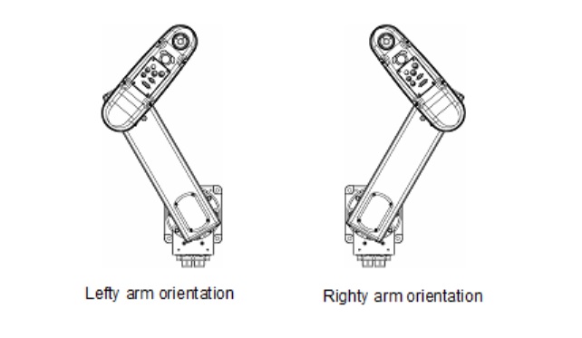

The robot points on a SCARA may include a “hand” parameter, defined as lefty or righty. The hand parameter tells the robot which orientation the robot arm should be in for a specific taught position. If the hand parameter is not defined, the move to the position may cause collisions, and it may have a different orientation in two successive moves to the position.

SCARA arm orientation
Figure 3. Arm orientation from the top view of a SCARA robot.
