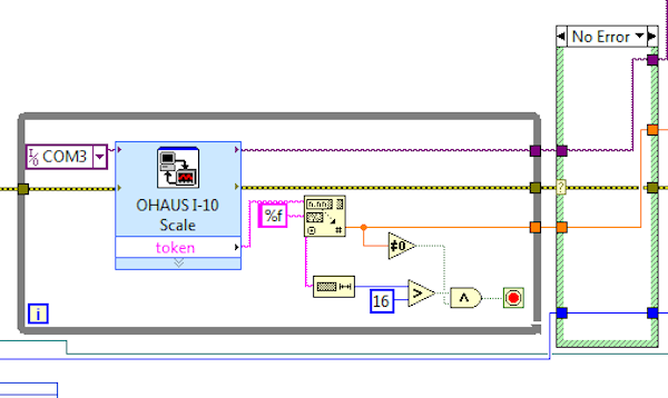

The status boolean can determine an error, which is often fed into a case structure to handle the error. For convenience, LabVIEW is smart enough to know that an error cluster fed directly into a case structure will automatically check the status boolean. The programmer does not have to unbundle it separately. Case structures with an error cluster as input have their own special labels and colors: the two cases are “error” and “no error,” and the case structure border is colored green and red, respectively.
Figure 2. In this piece of a VI, a mass is taken from a scale.
If the scale reads properly in figure 2, the “no error” case is active. If there is a problem, rather than crashing the VI, the error cluster’s status is set to true, and the “error” case is active.

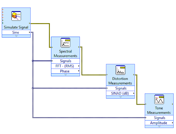

Error clusters can also force the run order and ensure that a VI’s nodes are placed in a determinate order. To connect these and force the run order, place the nodes in order from left to right, then connect the “error output” from the left-most node to the “error input” of the next node, and continue this process through all of the nodes that need to be determined.
Figure 5. The error cluster forces the run order: simulate signal, spectral measurements, distortion measurements, then tone measurements.
If the error cluster wires were removed in figure 5, the simulate signal would happen first; then, the others would occur in a seemingly random fashion, running in different orders each time the programmer executed the VI.
