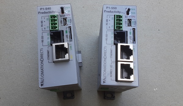

Comparing 1 vs. 2 Ethernet ports on two CPUs
Figure 1. Two otherwise quite similar CPUs, differentiated in the number of network ports. In this case (the Productivity P1-550), the second port, called Remote I/O, is preconfigured for Modbus TCP on a separate network.
Two Ports with One Configuration
This option is based on devices that have a built-in network switch. It is a bit of a compromise between the one-port system and the two-port system, allowing multiple devices to be connected, but only addressable through one port. This makes network segmentation possible, which means traffic can be physically segregated.
Consider a piece of equipment that has a data stream for archiving and troubleshooting purposes and a command stream where control commands are issued. With a two-port system, these two streams of information can be segregated. By placing the remote data server on one port, while the connection to the plant floor exits on the other port, a more logical separation can be created. However, both networks still share the same connection, and security may be a risk factor.

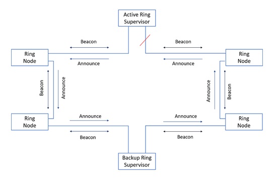

Device Level Ring (DLR)
Another major advantage of two shared ports is the security of redundancy. A network concept called device level ring (DLR) provides all devices in the network with two traffic routes to all other devices, in one big daisy-chained loop. If any of these cables fail or become disconnected, all devices maintain a connection with all others.
Device level ring (DLR) network topology
Figure 2. A device level ring, or DLR, diagram illustrates how if a single branch loses connection (like the red line near the top, breaking a cable), all nodes can still communicate. Image used courtesy of HMS Networks
The internal network switch adds a layer of complexity, and as with all network switches, it must be a little slower. Even though there are multiple devices, only one can be accessed at a time. For high-speed applications, this could become a problem, as the time delay during switching means equipment is moving without control for those fractions of a second while communication to the other device is occurring.
