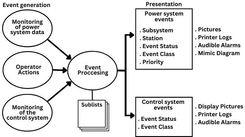

Task Processing for SCADA Events
An event in the SCADA system is defined as any change in the detected state of power or control system. That change may be caused by a system response change in the process or in the SCADA system itself, or it may be caused by operator actions. Event presentations always give a detailed and selected view of the event status of the power system. Event processing functions maintain the event lists and alarm lists. The event lists are a historical record of the events while the alarm lists are just the current alarm status of objects.
In general, any SCADA system can perform several tasks for event processing:
  1. Partition of event storage for different sets of lists
  2. Classification of events for the subsystem, e.g., production and transmission systems and control systems
  3. Counting persistent and unacknowledged alarms per subsystem and station
  4. Initiating system response due to an event by activating different functions such as updating the operator screen, audible alarm, or mimic diagram
Event status is determined through event processing groups, and event class is determined by data type, which will be discussed later.
Flowchart of event processing, from event generation to final action.
Figure 2. Flowchart of event processing, from event generation to final action.
Event processing functions maintain an event list and an alarm list, which are further subdivided into the following event sublists:
  • Power system event
  • Control system event
  • Program traps event
  • Database maintenance
  • Power system alarm
  • Control system alarm
The multiple lists presented to the operator are all extracted from these internal sublists. The key concept that is necessary to understand is that the event processing for an object involves the event processing group parameters and object subsystem identification to determine the particular sublist to update. The event sublist is designed to wrap around the list, meaning that more recent events always replace the oldest event in the sublist.

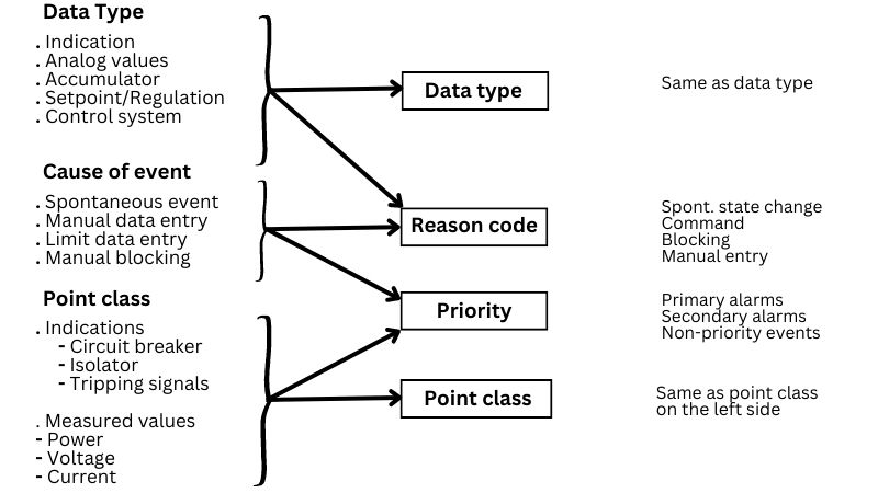

3. Event class: Data type, Point class, Reason code, Priority
The event is also assigned a unique class that is used to construct the message and the event clause parameter and for sorting the presentation into priority order. The event class consists of four independent parameters:
Data Type
Data type is the concept from the database point of view and data is determined for which the events belong like indications, measured and setpoint values, and control system devices. Standard data types include:
  • Indication
  • Measured value
  • Accumulator
  • Setpoint and regulation command
  • Control system unit
  • Remote terminal unit
  • General System Event
Point Class
Point class refers to a group of objects based on the type of device and position in the process. Examples of point classes are breakers, isolators, transformer fault signals, high voltage active power readings, etc.
Reason Code
The reason code is utilized for the classification of the event with respect to its cause. Examples of reason codes are spontaneous events, control responses, etc.
Priority
Each event is given a certain priority based on the point class and cause of the event. Each combination of these two can be given priority.
Event class parameter descriptions.
Figure 3. Event class parameter descriptions.
