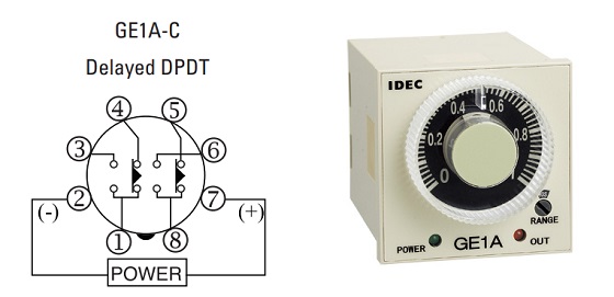

On delay timer relay and wiring diagram
Figure 2. An on-delay DPDT timer relay with no reset function. Image (modified) used courtesy of Idec
When the timing is complete, the output contacts energize, and the NO contact is connected to the common terminal. In the PLC version, this equates to the Q output becoming ‘true’.
Those output contacts will remain energized until the control logic is removed.
A summary of the sequence in layman’s terms might go like this: When the input circuit is activated, the timing begins. As long as the input stays activated, the output turns on after a short delay. Deactivate the input to turn off the timer.
