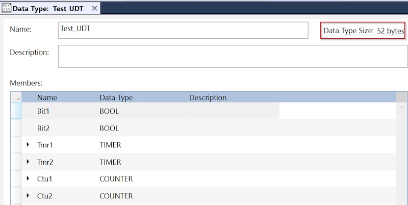

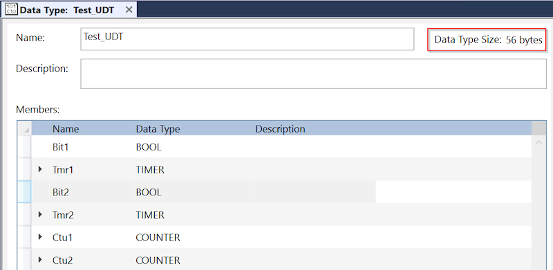

With Rockwell Automation’s Studio 5000 Logix Designer as an example, tags in the UDT should always be ordered from smallest data size to largest. The reason for this process has to do with how the software allocates memory for the different data types. Logix Designer will allocate more memory to larger data types such as timers, strings, and other large standard structure tags if they are structured near the top of the UDT.
Consider the following example to illustrate: with smaller data types at the bottom, the software will round up to the nearest byte. The following images show two UDTs with the exact same tags but arranged from smallest to largest (top), versus somewhat scattered (bottom). Note the data type size of each, outlined in red. Arranged in order leads to the most efficient size.
Efficiently designed UDT with the smallest tags at the top.
Figure 2. Efficiently designed UDT with the smallest tags at the top. Image used courtesy of the author
Figure 3. Poorly designed UDT with the tags in a more randomized size order. Image used courtesy of the author
UDTs with a large number of BOOL tags will also produce a larger total-sized UDT. This has to do with how Rockwell (and really, any computer) allocates memory for single-bit data types. Each Boolean tag takes up one address, which is 32 bits long, even though it is only one bit in useful size. If you made a UDT with only one bool, the size of that UDT would still be 32 bits (4 bytes), while the remainder of that memory is wasted space.

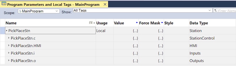

For example, imagine a pneumatic pick and place station which consists of a horizontal and vertical pneumatic cylinder along with a gripper. It might make sense to develop the following UDTs for communication and I/O:
  • One UDT for the station control
  • One UDT for HMI controls of the cylinders
  • One UDT each for mapping the input sensors and output solenoids of the cylinders
All of these UDTs could be put into one UDT so that all of the tags for that station would take up the space of one tag in the tag database.
Figure 4. One UDT tag consisting of 4x nested UDTs, each performing a dedicated function. Image used courtesy of the author
At first glance, this solution may look like a great idea, but what if you wanted to search for a specific HMI tag? The search would come up with nothing because searching a tag database will only search the root tag name.
Another challenge resulting from embedding multiple tags is the appearance of very long tag names. If you wanted to address the input sensor for the cylinder above, it might look something like this: “PickPlaceStn.i.vertical.inputs.extended.” That’s a fairly long tag name for one input.

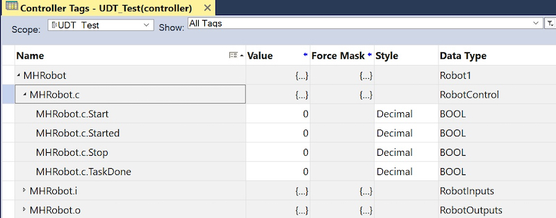

From my own experience, I prefer to divide UDTs into major functions. That means one UDT for my station control, one for each Ethernet device, such as robots or cameras, and finally, a dedicated UDT for all the station inputs and all the station outputs.
The thought process behind this method recognizes that because the tags for the device are unlikely to change, it makes sense to consolidate them into a UDT. The station control logic shouldn’t really change after the code is debugged and commissioned, and even robot communications don’t change much after integration.
No Need to Brood Over Nesting UDTs
As for nesting UDTs, I try to only nest one layer deep. When I make a robot UDT, I’ll have the local control bits in the root, then I’ll have an input tag and an output UDT tag, each of which gets copied out to the Ethernet module. This also helps with future expansion into multiple robot systems, each subsequent robot can use the same control bits while customizing the mapping bits.
