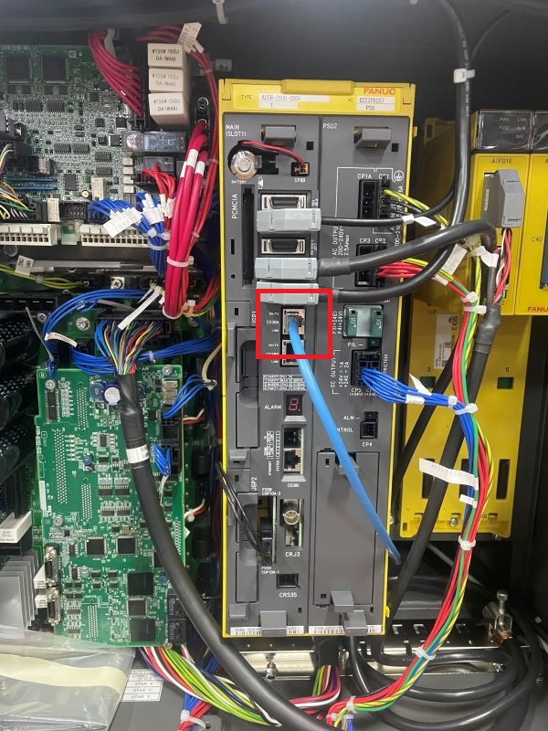

Figure 1. The location of the Ethernet Plug:1 within the R30iA/B controller. Image used courtesy of the author

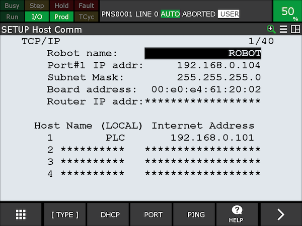

Setup Host Communication: FANUC Teach Pendant (R30iA/B Controller)
The robot's host communication settings must be configured to ensure proper communication through the Ethernet network.
Figure 2. Host Comm Setup: Menu > Setup > Host Comm > F3 for (Port), and then choose either port 1 or 2, depending on where you plugged in the Ethernet cable. Image used courtesy of the author
To set up the host communication, follow these steps:
- Navigate to the host comm setup page.
- Change the IP address for Port #1 or Port #2 as necessary. It's usual to set the IP address to almost match that of the PLC, differing only by the last number (octet) in the address.
- Click the right arrow in the bottom right corner to find the initialize button.
- Press the INIT button on the port to establish a connection.
- Under “Host Name (Local) Internet Address,” name your PLC and enter its IP address.
- Press the INIT button again while the “PLC Host” is highlighted. Again, initializing ensures everything is connected correctly.
- The “PING” feature can verify a successful connection.
- Cycle power through the teach pendant or robot controller to finalize the changes.

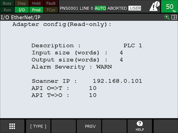

In the Ethernet/IP adapter screen, you must specify the I/O size, measured in 16-bit word sizes. For example, if you require 32 bits for input and output, you would set the size to 2 words each. By default, the adapter connection is configured for four words (64 bits) each for inputs and outputs. Any changes to the I/O size will require you to restart the robot before the changes take effect.
Note: The I/O size set on the robot controller must match what is specified in the PLC device setup; this will be important when setting up the PLC Ethernet communications.
Figure 3. Ethernet/IP List Screen. ‘TRUE’ indicates that the PLC is enabled and operational. Image used courtesy of the author
Figure 4. Ethernet/IP Adapter screen. Image used courtesy of the author

- Use the cursor to navigate to the “ENABLE” column and turn on the adapter by pressing (TRUE) with an (F) command button. If you plan on changing the needed words, press (FALSE), modify the words, and then change it back to (TRUE).
- Select enter the desired connection number in the description column (the adapter connection we selected is [1]). Then, press (CONFIG).
- Enter your required input and output sizes.
- Lastly, restart the robot to apply the changes with [FCTN] > [CYCLE START].

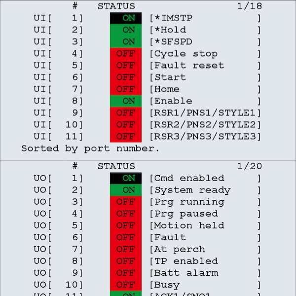

UI and UO (UOP Signals) Configuration: FANUC Teach Pendant
UOP signals serve as the vital link for communication and coordination between FANUC robots and external devices like PLCs. These signals can provide functionalities like starting, stopping, and controlling robot programs directly through a PLC controller. These signals are configured similarly to digital outputs and serve specific functions assigned to each signal type. They are already labeled and tasked with specific roles.
To make a long story short, you will use these signals to start the robotic program from a PLC/ HMI. For future reference, [IMSTP], [HOLD], and [SFSPD] must be enabled to start a program.
Figure 6. Navigate through I/O > Type > UOP (IN/OUT) to reach these screens. Image used courtesy of the author

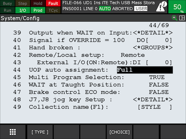

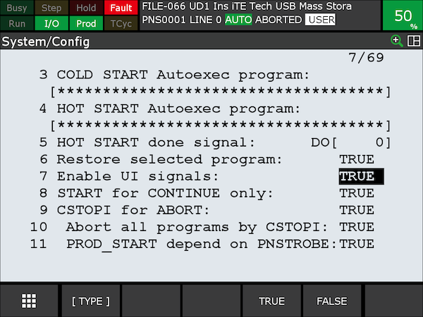

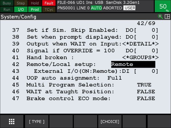

Figure 7. Enable UI signals: menu > system > config. Image used courtesy of the author
Figure 8. UOP auto assignment: menu > system > config. Image used courtesy of the author
Figure 9. Remote/local setup: menu > system > config. Image used courtesy of the author
First, we need to enable the UI signals to allow communication between the PLC and the robot through these signals. For setting #44, remember that the external signals (UI [1 to 18]) are turned off when the value is set to FALSE. This value should be switched to FULL to allow programs to be initiated by the PLC. Lastly, on line #42, change [LOCAL] to [REMOTE] to complete communication with the PLC.

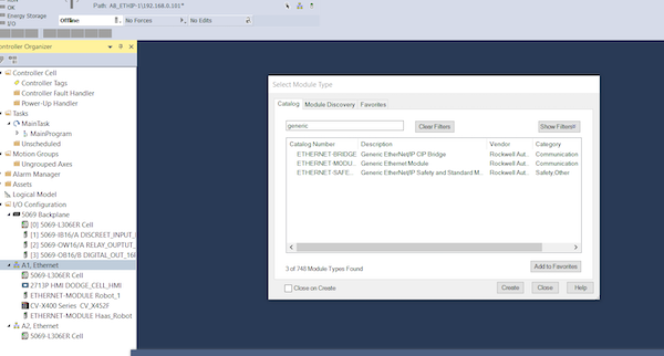

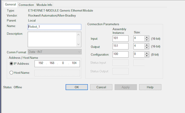

On the PLC side, the setup is fairly straightforward. We'll configure a generic Ethernet module via the “A1, Ethernet” tab. The accuracy of this setup is crucial, as any errors in data entry could prevent communication between the robot and the PLC.
Begin by entering the robot's correct IP address. Then, under connection parameters, ensure the assembly instance information matches; Input: 101, Output: 151, and Configuration: 100. The input and output can vary between different robotic controllers or different ports: see the robot manual for further instructions. The size should always correspond to the number of words you configured for your robot earlier in this tutorial (remember, we used 64 bits, which is 4x 16-bit words), and keep the configuration size at zero.
Figure 10. Locating the “Generic Ethernet Module.” Image used courtesy of the author
Figure 11. Configuration of the robot module Ethernet device. Ensure that the assembly instances are input correctly and that the sizes align with the settings previously input into your teach pendant. Image used courtesy of the author

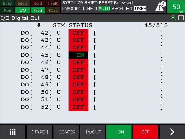

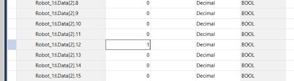

Checking Ethernet Communication Through I/O Monitoring
We will manually activate an output signal on the robot's teach pendant and then check if this change is reflected in the PLC for the robot's inputs. Remember, the robot’s digital output on the teach pendant is correlated to a robotic input signal on the PLC.
Figure 12. Digital output [45] is manually forced on for testing. Image used courtesy of the author
