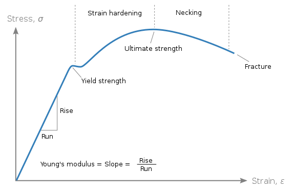

Materials are loaded in a mechanical tester and stretched. The machine stretches the material at a constant rate, and the stress on the material is measured and plotted as a function of strain. An example is shown here:
Stress and strain curve regions
Figure 1. Stress and strain curve regions. Image used courtesy of Wikipedia
Several things can be learned from this plot. The first part, up until the “yield” point, is called the “elastic region.” If the material is stressed this far, it will spring back to its original shape once the load is released. If the material is stressed higher than the yield strength, the material is in the “plastic region” where permanent damage is being done. This is where the paperclip example lies: the paperclip is bent permanently, then bent back to its original shape.

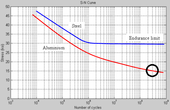

To measure fatigue, materials are stressed repeatedly at a certain value until they fail. Then a new stress is selected, and a plot of stress versus the number of cycles is generated. This stress and number (S-N) curve is used to predict the number of cycles until a part fails. An example of this curve comparing aluminum and steel is shown here:
S-N curve for a steel alloy versus an aluminum alloy
Figure 2. S-N curve for a steel alloy versus an aluminum alloy. Image used courtesy of Wikipedia
In Figure 2, the aluminum alloy has a number of cycles to failure, even at low values of stress. For example, at a stress of 15,000 psi, the material is good for 2x10\(^8\) cycles, indicated by the circle on the curve. Notice the steel sample has an “endurance limit,” which means that stresses below this value will not cause the material to fail by fatigue.
The high number of cycles is misleading. It sounds like 200 million is a lot of cycles, but suppose this was the cyclic stress on an engine’s crankshaft, spinning at 2,000 rotations per minute. The crankshaft might fatigue at under 3,500 hours, or roughly one trip around the beltway at rush hour in Washington, D.C.

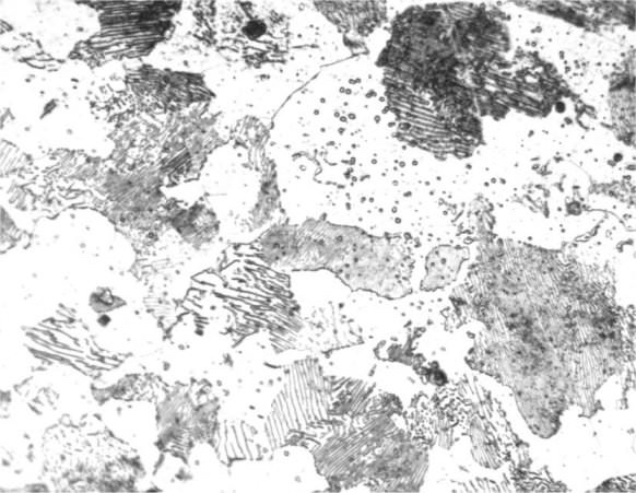

These graphs work well for ductile metals. Under a microscope, the metals have a microscopic grain structure. As the material is stressed, it can slide ever so slightly along these grains. Over repeated cycles, these movements can organize into cracks that will eventually cause the material to fail.
1045 steel under a microscope
Figure 3. 1045 steel under a microscope. Author’s image
