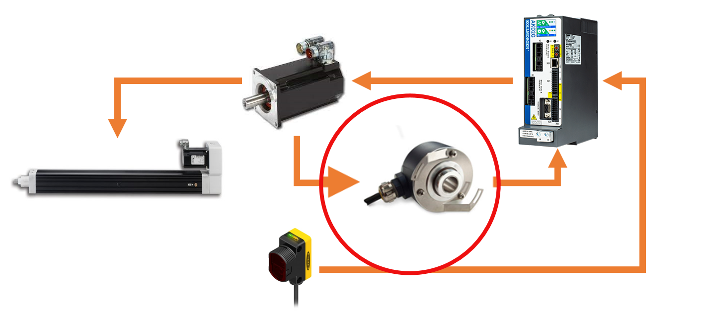

Figure 1. A simple servo system consisting of a drive, motor, encoder (magnified), actuator, and sensor.
Say we need to move our motor to a target, but the target’s position is variable. This would make the distance our motor needs to traverse (the number of times its shaft rotates) variable. We need a way for the motor to know where itself is located relative to the goal position at all times to complete this move successfully. We need feedback.

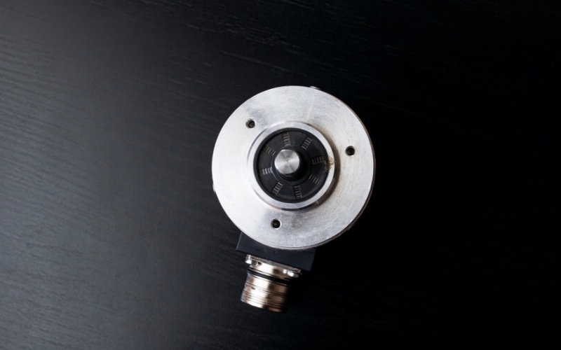

When using a servo motor, it is typical to see built-in feedback devices, such as an encoder or resolver. These feedback devices continuously monitor the position of the motor’s shaft. With this information available, the motor not only knows its shaft position but can also deduce its velocity in real-time. Knowing this information, we can then command the motor to move in a more controlled way and perform more complex tasks.
Figure 2. An encoder laying flat on a table.

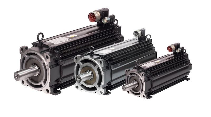

Figure 3. Rockwell’s fanless servo motors. Image used courtesy of Rockwell Automation
