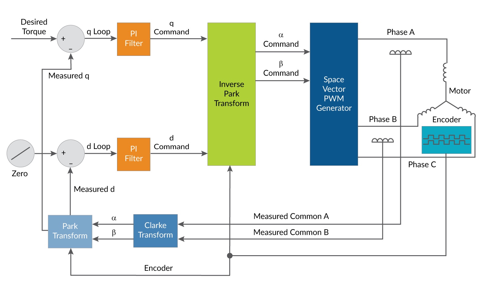

Figure 1. Field-oriented control diagram. This strategy is also used in variable frequency drive (VFD) systems. Block diagram includes the PWM generator and the encoder used to provide feedback for the PI controller. Image used courtesy of Performance Motion Devices

Vector Control
Vector control makes a smooth transition of current that constantly updates electromagnet states as it turns through its cycle instead of following a square wave. The position is relayed to the FOC control module. Two components of the current vector must be monitored: the orthogonal component and the flux component.
Figure 4. FOC is also known as vector control. Image used courtesy of TRINAMIC
The target value of flux is zero, so the system continuously fluctuates to make the flux value zero. As motor speed increases, flux is an increasing problem for hall effect control since the effect of state switching becomes more pronounced. Higher motor speeds are where vector control has a major advantage. Because the control unit continuously monitors and adjusts to ensure the flux vector is zero, near-maximum speed and efficiency are possible.
