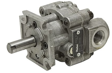

hydraulic motor example
Figure 1. An example of a hydraulic motor. Image used courtesy of Parker Hannifin
Hydraulic Motors
A hydraulic motor is similar to a hydraulic pump. Both convert input energy from one form to another, and they even look similar internally, but the differences will prevent a motor from being used as a pump. With a hydraulic motor, pressurized fluid is forced into a chamber with an actuator, gear, vane, or some kind of rotatable surface. The fluid takes the path of least resistance and pushes against the surface, which rotates the output shaft. There are three different kinds of hydraulic pumps with varying versions of the above description.
  • Gear
  • Piston
  • Vane
With the piston motor being the most efficient, you can expect an efficiency rating of between 80% to 90%. Just like electrical motors, friction is a cause of loss, but with hydraulic motors, there can be internal losses due to fluid leakage from wear or poor-quality materials.

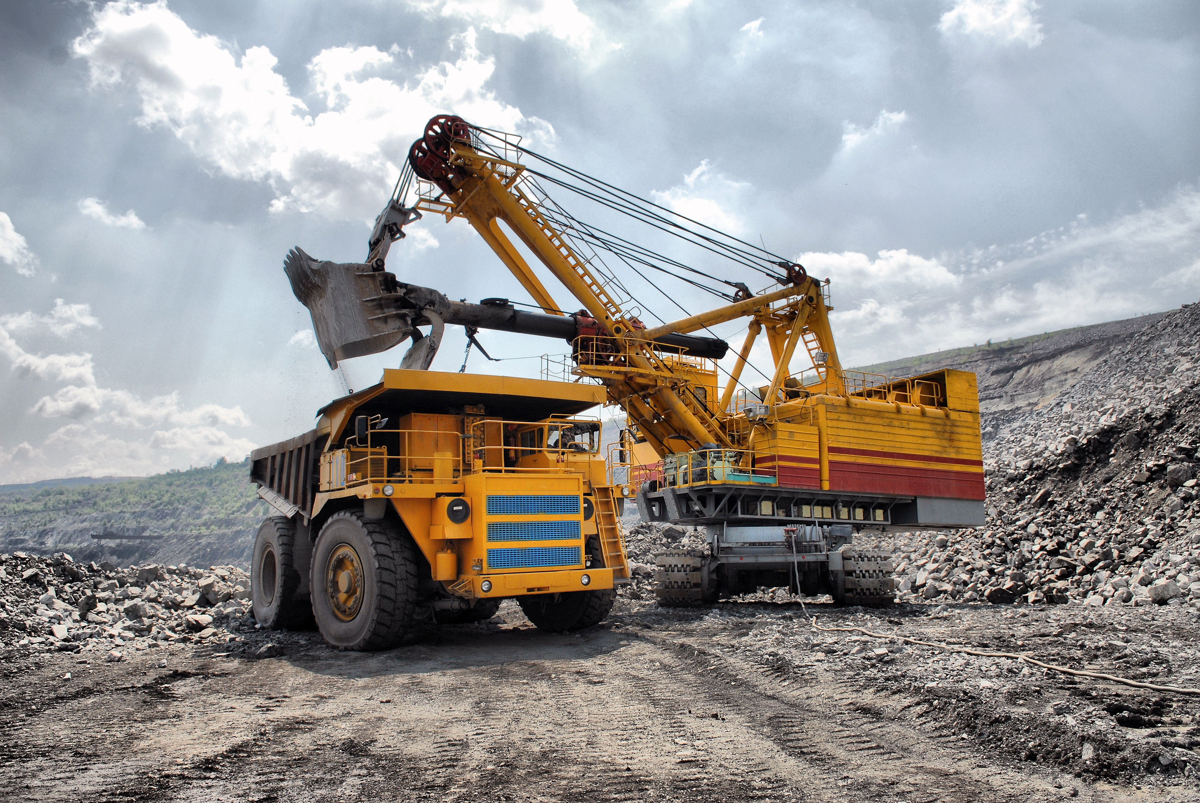

The obvious application or location is with remote equipment, such as front-end loaders, backhoes, mining equipment, or logging equipment. This equipment already has existing hydraulic pumps and actuators, so adding a hydraulic motor can be a simple solution.
Equipment driven by diesel motors in remote locations does not have access to the high voltage that a typical electric motor would require, but they do typically have access to hydraulic systems. Adding a hydraulic motor to an existing system might be more complicated than plugging in an AC electric motor. These hydraulic systems are specifically designed for the number of devices within the circuit, so always consult the equipment manufacturer before altering the hydraulic system.
Remote, heavy-duty equipment, like a mining machine, relies on hydraulic systems for a large number of functions
Figure 2. Remote, heavy-duty equipment relies on hydraulic systems for a large number of functions. Image used courtesy of Adobe Stock

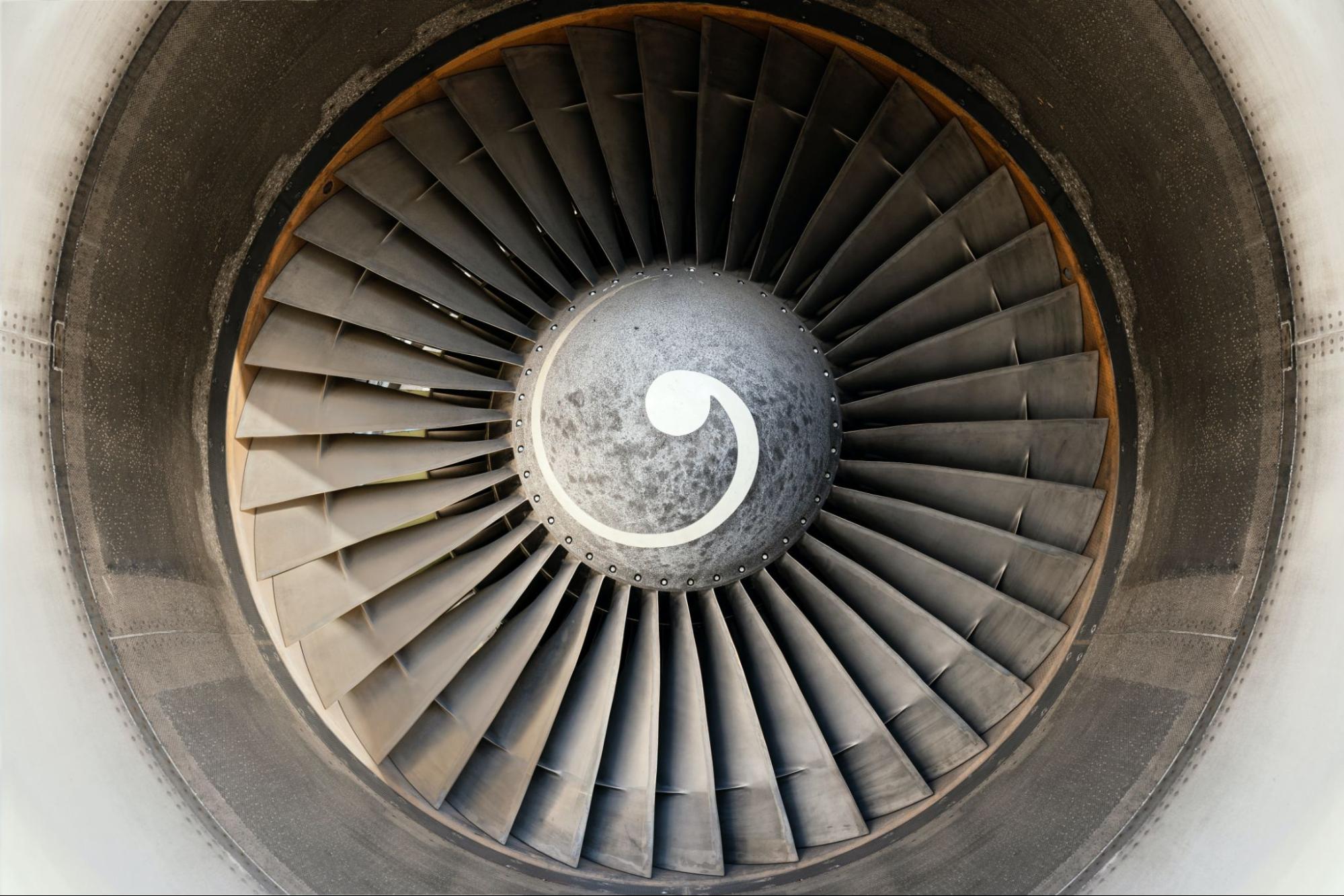

Airplane engine with angled vanes for rotation
Figure 3. Airplane engine with angled vanes for rotation. Image used courtesy of Unsplash
Pneumatic Motors
A pneumatic motor is similar to a hydraulic motor, except for the obvious difference that compressed air is used as the source of energy. Compressed air is directed into a chamber with surfaces that are attached to a rotating shaft. When the compressed air pushes on the surface, the shaft will rotate. The most commonly used air motors are vane, piston, and turbine, with the turbine being the most efficient. Typically a turbine is about 65% - 75% efficient, which is higher than other models of air motors. The turbine doesn’t require lubrication and has less internal friction.
