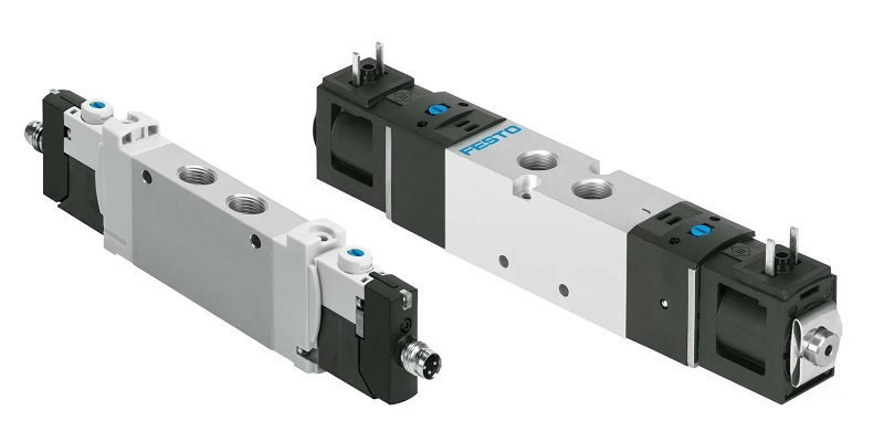

2-way 5-port Directional control valves
Figure 1. The solenoid valve is one of the most common sights in a modern pneumatic system. Image used courtesy of Festo

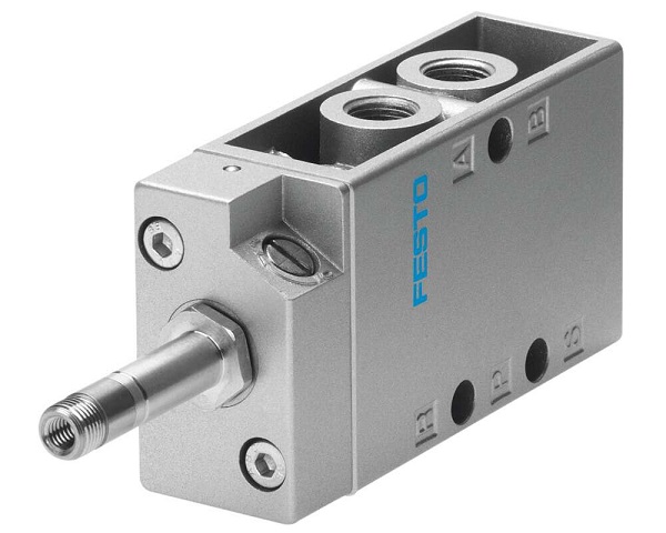

Some manufacturers put markings on the valve body next to the ports to define the static function of the ports. A two-port valve may only have an arrow on the valve body that shows the direction of flow for that valve. A 5-port valve requires more detailed descriptions for the different ports. Valve markings are fairly standard across manufacturers but they can differ, so always refer to the valve manual for proper connection. Typically there are four markings that can be found on pneumatic or hydraulic.
  • ‘A’ & ‘B’: These are the work ports or output ports. If you are controlling a pneumatic cylinder, these ports would be connected to the extend and retract ports of the cylinder
  • ‘P’: Refers to the pressure or pump, basically this is the supply port for the valve.
  • ‘T’: In hydraulic systems, the fluid needs to return back to the tank, the “T” port refers to the tank or return line. In a pneumatic system, this is referred to as the exhaust port. Sometimes mufflers are screwed into these air exhaust ports and sometimes hoses are used to vent the exhaust air to a safe location.
With these marking being relative to hydraulic systems, some manufacturers will alter the makings to represent pneumatic systems. Instead of using ‘T’ for tank, ‘EX’, ‘E1/E1’ or ‘R/S’ might be used to represent exhaust. The ‘P’ marking could mean pressure or pump, but some manufacturers will use ‘IN’ to indicate where the input pressure medium should be connected.

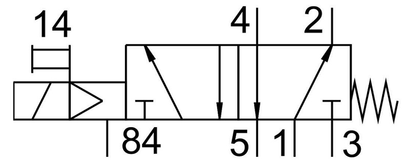

Numbers are frequently used as well to indicate the connection ports.
  • 1: Input, equivalent to ‘P’ or ‘IN’
  • 2: First of the work output ports, equivalent to A
  • 3: Exhaust for port 2
  • 4: Second of the work output ports, equivalent to AB
  • 5: Exhaust for port 4
These seem to be placed in a random order, but note that for 3-port valves, only the first three numbers are used and the definitions remain true.

    I’d like to add two practical details that may be missed by someone like me who’s only occasionally had to deal with pneumatics:
    1: The photograph depicts a valve with two actuators, meaning it has a neutral position and two directions. The symbol depicts a valve with one actuator meaning it defaults to an active position. This means that a driven cylinder will actively move to its “base” position if power is lost. Occasionally this may be desirable behaviour in order to drive a system to a safe state if control is lost, but more often it risks causing unexpected motion. It also means that in the event of a pipe break there may be no way to isolate the cylinder unless there is an upstream valve.
    When driving anything of significant size it is sensible to assume the need for a two actuator valve, it can be swapped for a sincle actuator type if power-loss behaviour later turns out to be desirable.
